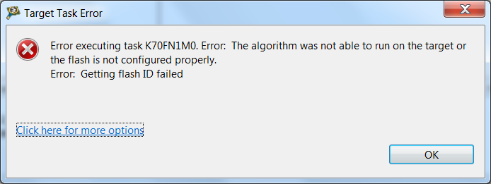

I'm using since few week the TWR-K70F120M Tower Module and I flash and debug it via USB port directly connected on the board.
I haven't yet any problem to use it.
Then I need to use External Nadflash for my software. (I have question about this here: K70 flexnvm used for program flash)
But during my manipulations, something works bad and then since I'm not able to flash the board :smileyconfused:
The debug procedure stop when tcl file is loaded
With the P&E linled to the JTAG  on the board, whenI try to do a "Flash file to target" -> "Erase whole device", following error occurs:
The Console write following:
fl::target -lc "LC for Simple Flash (2)"
fl::target -b 0x1fff0000 0x20000
fl::target -v off -l off
cmdwin::fl::device -d "FTFE_PFlash1M0" -o "128Kx64x1" -a 0x0 0xfffff
cmdwin::fl::erase all
Beginning Operation ...
Performing target initialization ...
Downloading Flash Device Driver ...
Reading flash ID .......
Error: The algorithm was not able to run on the target or the flash is not configured properly.
Error:  Getting flash ID failed
Please, have you an idea?

To return to the subject of this post, my problem was a problem to program a basic program (in internal flash) following my try to program the external flash which had failed.
All simple programs like "hello" I tried failed in programing. Error message was presented in my first post.
My collegue found how to resolve my problem.
Just need to tick the following option at least one time. After that, the programing works again.
