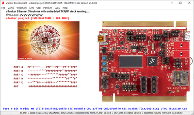

Try https://github.com/uTasker/uTasker-Kinetis
It contains a TWR-K65 FreeRTOS configuration (just enable target TWR_K65F180M) and chose between high speed run mode (enable USE_HIGH_SPEED_RUN_MODE) or not (don't enable this for 120MHz).
Beware that in HSRUN mode you can't write to flash and there are few other subtle restrictions.
It has a console on UART2 by default (change the define DEMO_UART from 2 to any other one as required) and will default to 115.2kBaud.
It can run in Visual Studio as simulated K65 so that full operating details can be easily checked and the simulation informs of clock speeds and the UART baud obtained:
- 180MHz core, 60MHz bus, 25.714285 MHz Flash and 115'163Baud
As you probably know UARTs 0 and 1 use core clock and the other UARTs use the bus clock so your calculating with the bus clock would be correct of UART2. This solution does need clock generation and automates the details internally and can be used either as faster project solution or as comparison to help debug code configured or generate by the configuration tools.
