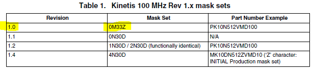

Hello, I don't know how stable is this solution but it helped me to get my code running. The problem is that MCG_C7_OSCSEL_VAL appears in the code not only one time. After fixing the clock initialization I got a problem with the UART initialization.
The TWR-K60N512, as I know, has some old Kinetis MCU. My board has revision D and uses the PK60N512VMD100 (Mask set 0M33Z). This MCU just doesn't have register MCG_C7. I expect that you use the same MCU. The best solution is maybe to switch to the TWR-K60D100M with newer MCU.
This Application Note explains the problem (https://www.nxp.com/docs/en/application-note/AN4526.pdf)
