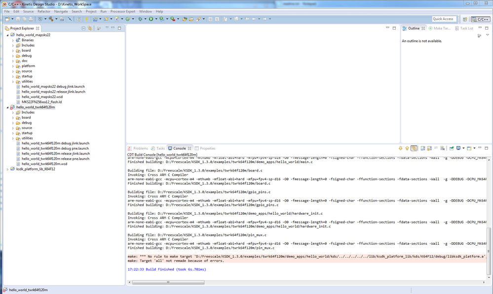

I just got my TWR-K60F120M stack eval boards; downloaded the KDS 3.0, KSDK 1.3 and 2.0.
Neither KSDK 1.3 nor 2.0 had any example for TWR-K60F120M.  I can only find TWR-K64F120M in 1.3.
I went ahead and import hello world project from TWR-K64F120M.
i compiled and it had error as:
make: *** No rule to make target 'D:/Freescale/KSDK_1.3.0/examples/twrk64f120m/demo_apps/hello_world/kds/../../../../../lib/ksdk_platform_lib/kds/K64F12/debug/libksdk_platform.a', needed by 'hello_world_twrk64f120m.elf'.
make: Target 'all' not remade because of errors.
17:19:18 Build Finished (took 221ms)
it seems to compile ok, but error on linking
Not sure what's going on.
so i decided to try the KSDK 2.0.  In there, i can only find the hello world project for mapks22.
i imported this project and it compiled and linked ok.
so, question:
1- would the KDS 2.x only work with KSDK 1.3 demo program?
2- is it ok to use TWR-K64F120M example on TWR-K60F120M?
Assume KDS 3.0 can work with KSDK 1.3 and TWR-K64F120M example is ok for TWR-K60F120M, what is the linked issue?
Thank you,
Henry

i think i got this compiled.  i had to import the platform lib first, compile and then import the hello world, and compile.
now a big question is that if i click on "copy to my work directory" it does not work.
if i want to create a project in my work bench/directory with a good starting point from one of these examples, what is the best way to do that?
Henry

The KSDK software for TWR-K64F120M board could not work for TWR-60F120M board.
Customer could get the bare-metal project for TWR-K60F120M board from here.
And the NXP MQX RTOS also provide demo for TWR-K60F120M board, more detailed info, please check here.
Wish it helps.
