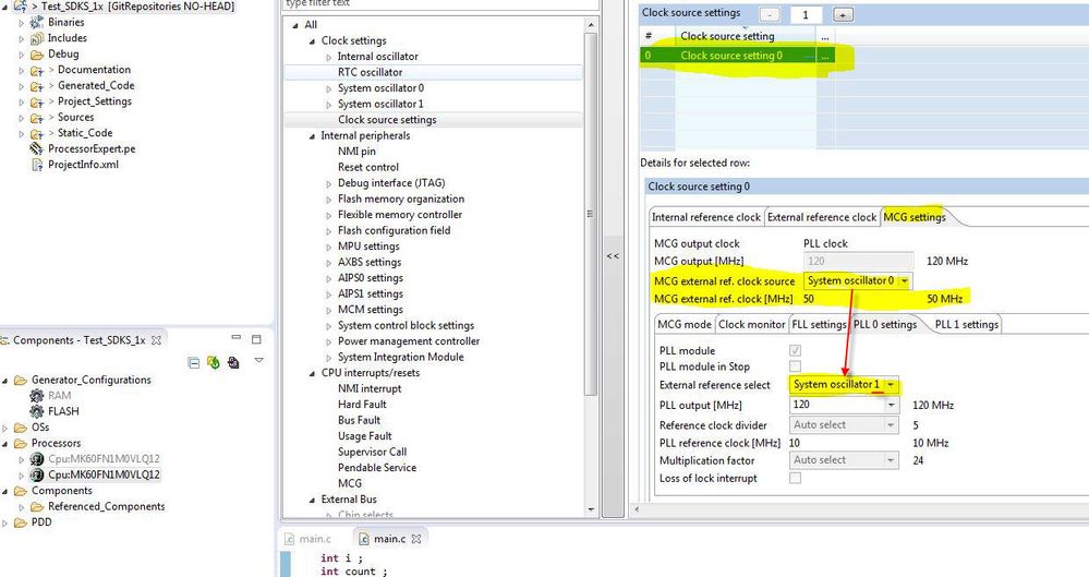

we have been able to create and blink light on TWR-K60F120M using internal clock feeding the FLL.
Now, we try to configure the OSC external ref clock (50 MHz from board) to feed the PLL and so on.
The code generation went fine and download OK, but it got stuck waiting for PLL locked at line 486 of Cpu.c file.
we use KDS 3.0 and KSDK 1.3.
Attached is the snap shot of the clock configuration and the generated clock configuration codes.
Our intention is to drive 50 MHz clock from the TWR board to the EXTAL1 input (system oscillator 1) and then use this clock to drive PLL.  PLL output is 120 MHz.  The 50 MHz External clock is divided by 10 prior to feed the PLL,
On TWR board, i have J18 ON to drive power to OSC and J6 off which means the 50 MHz osc clock is enable according to the schematic and the user jumper guide.
Can you please give us any comment on this?

I think the "MCG external ref. clock source" mean "MCG FLL external reference clock".
Since you want to use 50MHz external reference clock  drive PLL output 120 MHz . The "External reference select" in PLL 0 settings should be "System oscillator 0".

It seems that you have selected the wrong External Reference.
Robin

MCG External Reference Clock selection only gave user two options: System Oscillator 0 and RTC clock.  Not sure why. Now, i wonder what MCG External reference clock means?
However, searching around the web, i came to know that there is an issue with K60F120 silicon as highlighted by Erich Styger in the link below:
https://mcuoneclipse.com/2013/10/27/usb-with-the-twr-k60f120m-and-twr-k70f120m/
I followed his recommendation and make it passed through the PLL locking while loop.

Hi Henry,

Thank you for your help again.  I think i made a mistake when looking at the schematic on clock routing.
you are right.  the External 50 MHz does not have any restriction.  I tested that and it works well.
