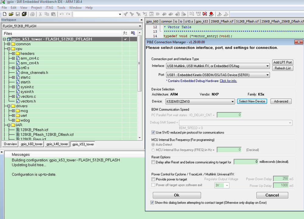

In IAR Workbench, I followed the "TWR-K53N512 Quick Start Demo Lab Guide" step by step!
However when I hit "Download and Debug", the PEMICRO Connection Manager shows:
Interface: USB Multilink, Embedded Multilink, or Embedded OSJtag
Port: Undetected. Disconnect/Connect USB cable. Click Refresh List.
Anybody know the solution?

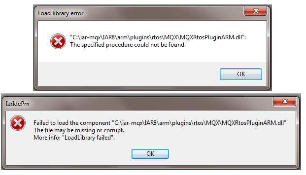

Actually I have already tried IAR-8.10, but when I open the workspace, I got another error:
"C:\iar-mqx\IAR8\arm\plugins\rtos\MQX\MQXRtosPluginARM.dll": the specified procedure could not be found."
Have you ever encountered this error in IAR?

nitinhrish
IAR v 8.10 is incompatible with MQX, another proof here: https://community.nxp.com/thread/446933

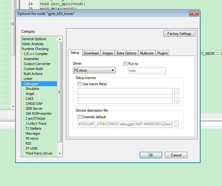

Hi Jerry Lian,
    1, Please download the PE driver from this link and install it:
http://www.pemicro.com/downloads/download_file.cfm?download_id=53
    2. You should better download a new IAR version, 6.10 is very old now, my IAR version is  7.8.
    3. Please configure it like this :
Please try it on your side.
If you still have question, please let me know!
Kerry
