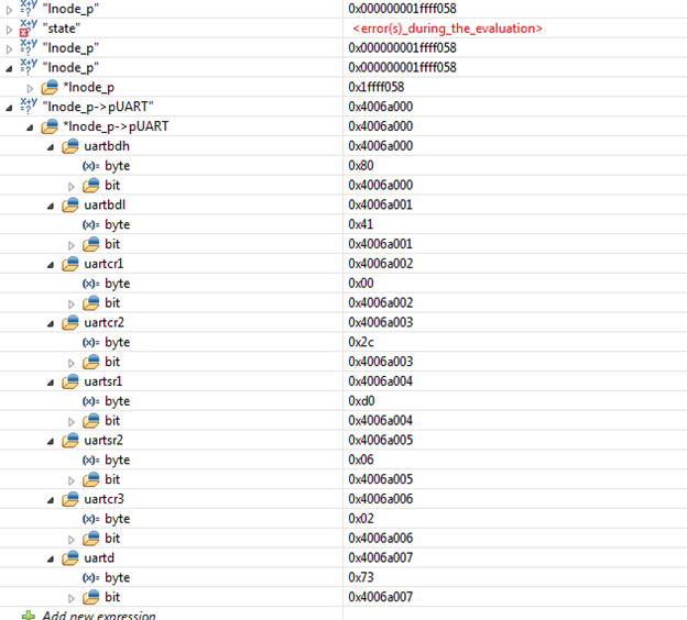

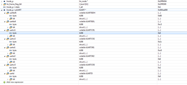

madhusandeept
Hello Kerry,
We got the KEA board working with populated R84, R85, R61 and I enabled EN_LIN and WAKE_LIN from software.
I am trying to port the code to K66 controller. Is there any configuration I have to do in extra than for KEA128?
With K66:
With KEA128:
