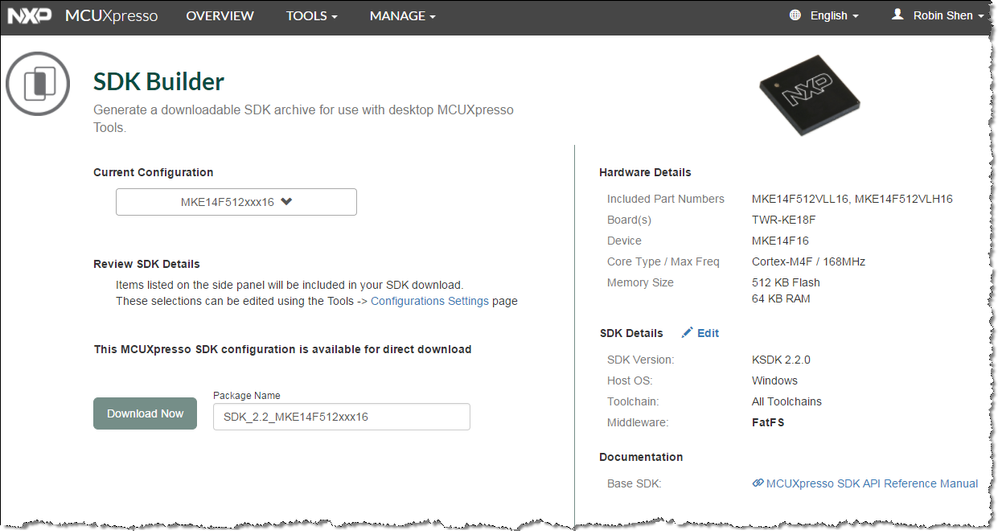

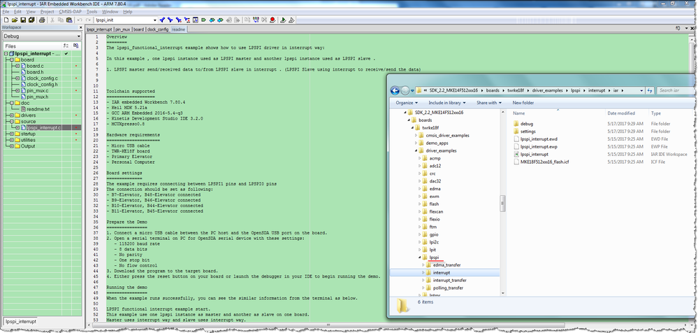

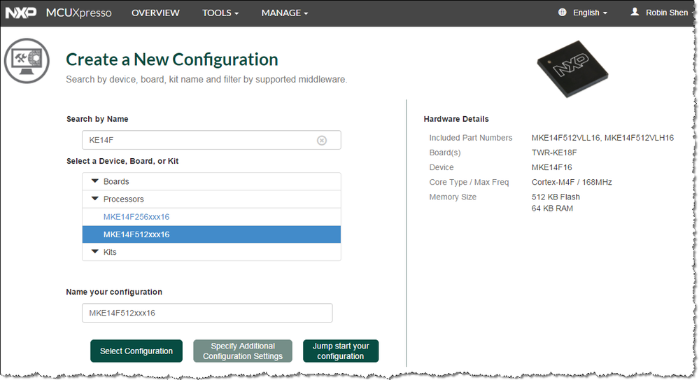

Robin_Shen
Have you try to test the LPSPI demo in SDK_2.2_MKE14F512xxx16?
Robin
3,087 Views
michaelheidinge
Yes, i had a look at the example, however I could not find the problem.
