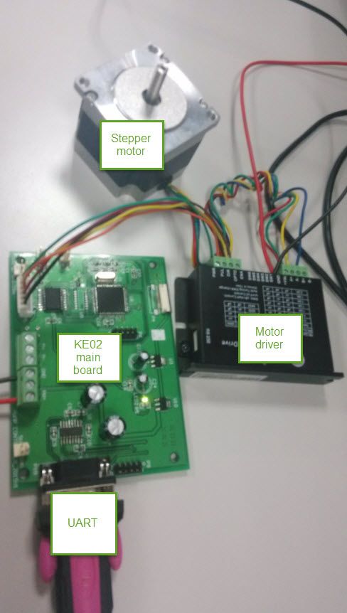

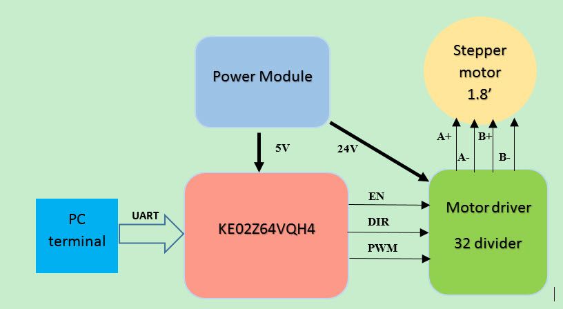

This document is mainly about how use the KE02 realize the Stepper motor speed, step and direction control. It can use the UART in the PC to control the Stepper motor speed. The following picture is the control diagram.
                                                                             Fig.1
2. Motor control parameter calculation
     Just as Fig.1 shows, KE02 should control the EN, DIR, PWM signal to the motor driver, then realize the stepper motor control. EN is the motor driver enable signal, 0 is enable, 1 is disable; DIR is the stepper motor direction control, 0, clockwise, 1 anticlockwise; PWM is the pulse signal to control the step and speed for the stepper motor.
      Stepper motor is 1.8’, it means a round have 360’/1.8’= 200 steps. But because the Motor driver have the divider, it is 32, so one stepper motor round should have 200*32 = 6400 steps.
      KE02 system, it use the external 10Mhz crystal, and configure both core and bus frequent to 20Mhz,  it use FTM0 module as the motor pulse generate module, bus clock with 32 prescale used as the FTM0 clock source, choose up counter. If need to change the motor speed and control step, just control the FTM PWM frequent and PWM counter.
For Stepper motor, one FTM period means one motor step. From the reference manual of KE02, we get that, the FTM period in up counting mode is: (MOD-CNTIN+1)*period of the FTM counter clock, if want to change the frequent of motor, just calculate the MOD of FTM is ok, then count the number of the FTM cycle, now assume CNTIN =0, then:

3. MCU pin assignment
PTF0 : DIR
PTF1 : EN
PTA0 : PWM
PTC6 : UART1_RX
PTC7 : UART1_TX

5 DEMO
About the test code, please find it from the attachment.
