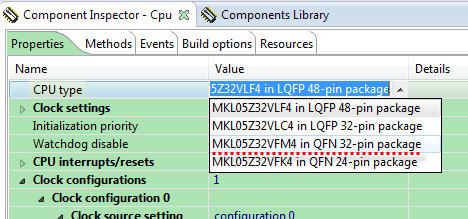

1.The Cpu what you should select is MKL05Z32VFM4.

I created this test project to remove all the unwanted code, but I forgot to define the processor.
