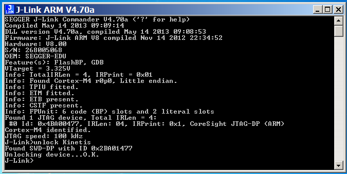

BTW: Segger provides Segger J-Link commander tool, which could use "unlock Kinetis" command to unsecure the Kinetis chip. While the presupposition is [mass erase is enabled] was set.

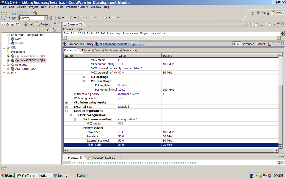

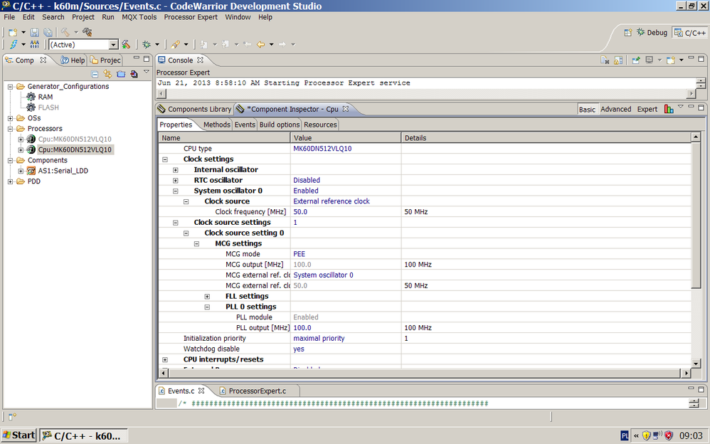

alexpaul
But it didn't helps, still the same error on PE_DEBUGHALT();
My settings after which is bricked

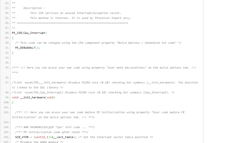

You have right, i made mistake while using project for MK60DN512VLQ10,while the chip on this board is MK60DN512ZVLQ10 but using that in FEI mode did not make a problem.
I tried both programing Ram and Flash with no difference.
Im always getting Pe_debughalt always at 91line.
http://pastebin.com/0UkDFqXL
Any ideas to revive this board?

Could you upload your test project? And could you direct in which file line 91, the core will run into Pe_debughalt function.
Thank you.

I can not open above link, could you post a picture and shows the line 91 info (better with file info).

alexpaul

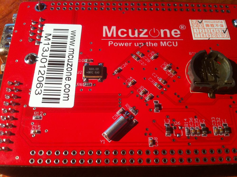

alexpaul
7,549件の閲覧回数
Kan_Li
I see the PCB topview, looks no ref clock available, would you please tell us how you connect the 50MHz clock or crystal to the board? a picture should be better.
Thanks for your patience!!
B.R
Kan
7,549件の閲覧回数
alexpaul
Hi Kan
oscilator is on the bottom side of the board
IMG_4876.JPGAnd significant part of scheme
