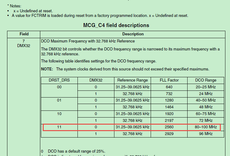

 If you want to get 100Mhz, from reference manual:
You can get that the input frequency should be 39.0625Khz.
If you use the 8Mhz external crystal choose FEE mode, you will find the you need FRDIV = 8000/39.0625=204.5.
Did the FRDIV have 204.5 data? No, please see this picture:

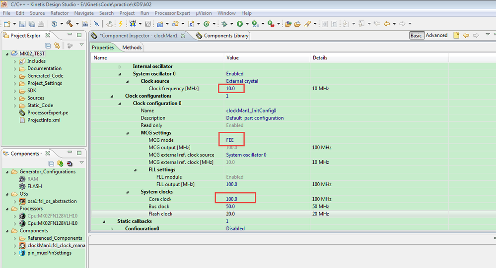

But if you choose 10Mhz external crystal, you can get FRDIV= 10000/39.0625=256, from the above picture, you can find FRDIV=0b011 meet the demand.
Actually, from the KDS PE configuration, you also can get that:
