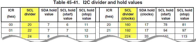

In the I2Cx_F register definition from the Reference Manual you can find the formula to get the I2C baudrate:
bus speed: Depends on your clock configuration (MCG module). For MK10DN512ZVLL10 the default bus clock frequency out of reset is 20.97152 MHz.
mul: It can be 1, 2 or 4 depending on the setting of the I2Cx_F[MULT] bits (00, 01 or 10):
SCL divider: According to I2Cx_F[ICR] (bits 5-0) there is an associated divider value specified in the table I2C divider and hold values:
EXAMPLE:
- To get a 100 kHz I2C bus frequency using the default bus clock frequency you can use the next values:
bus speed = 20.97152 MHz
MULT = 01 -> mul =  2
ICR = 0x16 -> SCL Divider = 104
I2C Baud Rate = 20.97152 MHz / (2 x 104) = 100.824 kHz

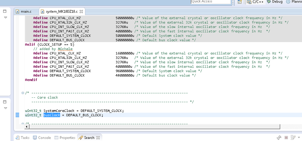

As it is a program that I passed to another person it is possible that this may have set the clock to 48 MHz?Immagin2e.png

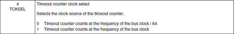

Referring to register I2Cx_SMB
The timeout must be 35 ms (then I have to consider for strength), but the clock to calculate formulas and SHTF1 SHTF2) is always the 48MHz?

If the project has an early call to a SystemInit() function and it is using the macros shown in your screenshot (with the macro CLOCK_SETUP defined as 5) as well as the same external crystal (16 MHz) then yes it is likely that the bus clock is 48 MHz.
The way to confirm this is by checking the MCG register configurations. Refer to the MCG Chapter in the Reference Manual. Another option to verify the clock in your device is to use the TRACE_CLKOUT pin as explained by colleague Derek Snell in the next post:
Verifying Internal Clocks in Kinetis
About the SMB timeouts, the frequency used is the one selected by I2Cx_SMB[TCLKSEL]:
