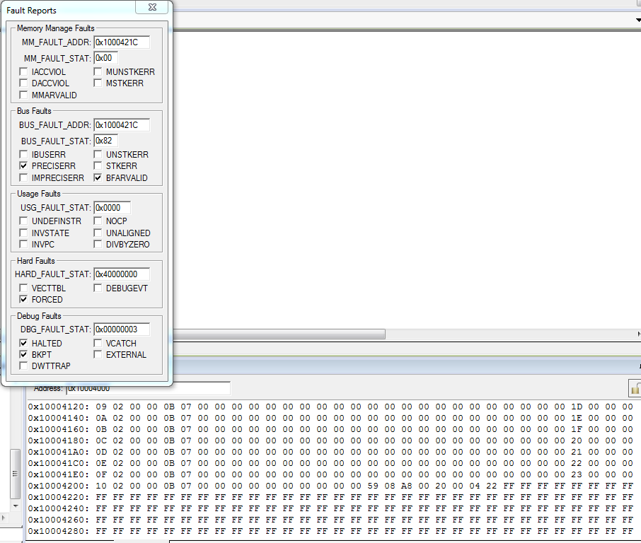

I write now some data to the flash and I think I have the problem which Earl said. I can not read the data on the next power on.
I see in the Memory window that not all data are written. If I read the data in line 948 with a normal pointer I get an Hard Fault conj an Bus Fault and from Bus Fault to Hard Fault. But this happened sporadic. I write 1000 times to the flash and only once the error occurs. In the followning 2 screenshots from the issue. I can not make the capacitor bigger. Is there a chance to spring from the Hard Fualt back to my software and read other data from flash when which are ok? Thanks.
Note: The pointer is 0x10004210 and the flash addresses from 0x10004210 to 0x10004217 on memory window should be 0x00 but the addresses are not 0x00? In this area I get the hardfault.

The hard-fault is, of course, just a vectored-interrupt, and you can put anything you like in the 'handler'.  I have NOT confirmed if there is any 'obvious' indication in the ARM fault-registers that would tell you said fault was a flash-access-read-error (like DFSR ending in 0x18 or 0x19?), you might look into that.  OR look into the stacked 'return address' pointing to the fault-location, and recognize that as your read-function -- and in that way 'discard' this 'latest' record and restore from a previous, known-good set of info.

I'd like to range of flash area you choose to save the data, and I'm afraid that you can't  should use the pointer to write or read flash, you should use the flash command to do flash operations.

I use the FlashProgram command to write to flash, but an simple pointer to read them. I try to use the flash command to read the flash. I found two read functions. FlashReadResource() and FlashReadOnce(). I think I need the FlashReadresource function? I see this function have the return value OK and FTFx_ERR_ACCERR. If I read the faulty flash area with this function and the return value is FTFx_ERR_ACCERR, would I jump to the Hard Fault ISR or not. And how can I recreate this error without writting 1000 times or often to the flash because the issue is sporadic? Can I write the same flash area 2 times to get the same issue?
