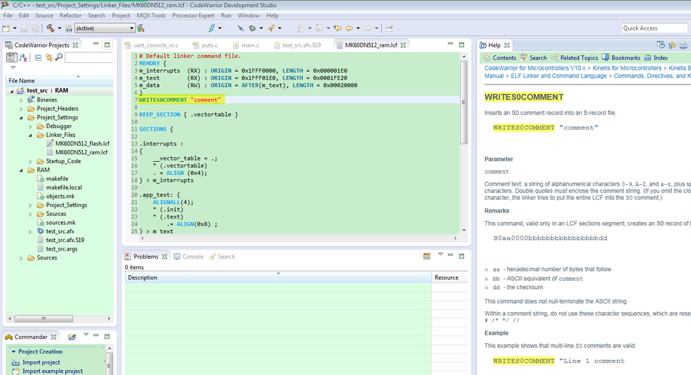

I am trying to adding a comment in the srec file for the kinetis MCU using CodeWarrior. According to the documentation, the WRITES0COMMENT should be used in the LCF. I however get a syntax error when attempting this. Can someone provide an example for how this is done. Thanks

Hi Cody,
   Do you want to add comment in the generated .srec file?
   If yes, you can add the S0 record:
S0aa0000bbbbbbbbbbbbbbbbdd
  • aa - hexadecimal number of bytes that follow
  • bb - ASCII equivalent of comment
  • dd - the checksum
You can use   WRITES0COMMENT "comment" in the lcf file:
Then build the code.

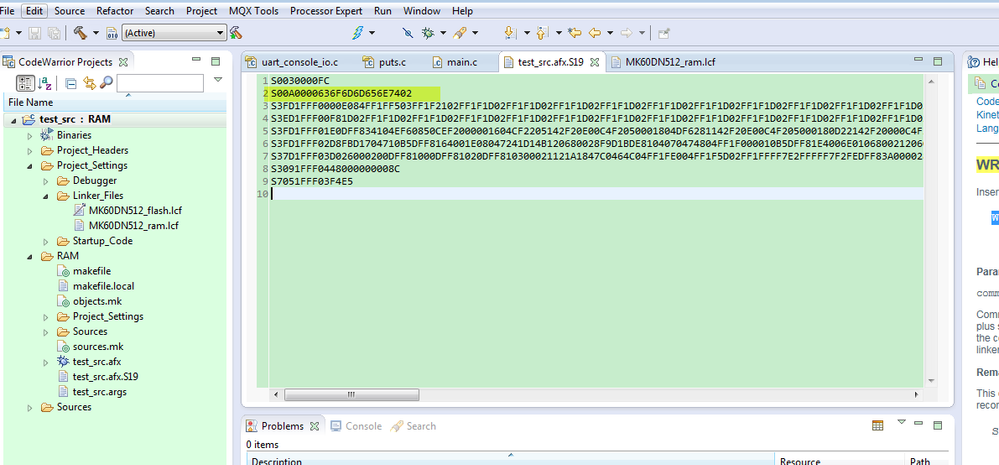

You can find I can generate the
S00A0000636F6D6D656E7402
It is the comment.
I also attached my cw project for your reference.
