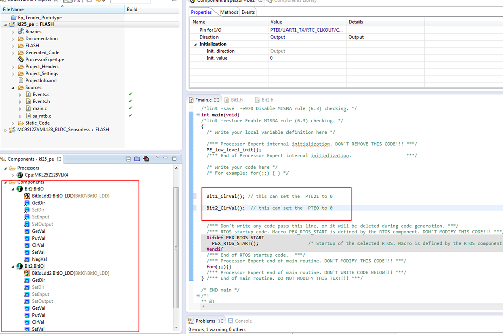

I don't understand how to "use two gpio connect the two SPI slave" in PE, can you give more details ?
Thank you
3,635 Views
OK !
Please add the "BitIO" component , then configure the pin you use , for example ,i sue PTE21 connect to spi1 slave, and PTE 0 connect to spi2 slave.
In the hardware, link the two pin to the "ss" pin of that two SPI slave.
3,635 Views
