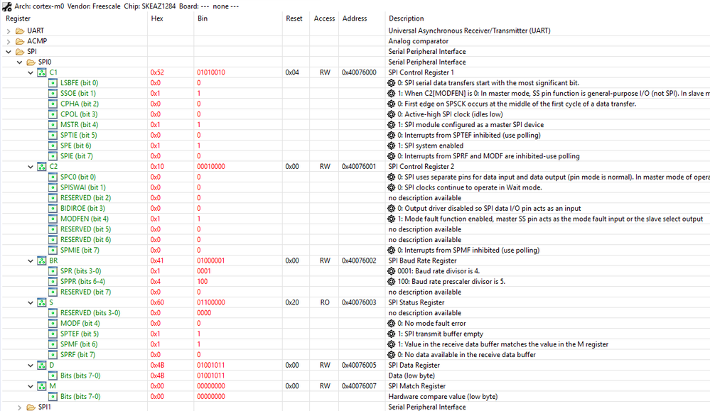

If the problem occurs, it is deadlocked in the last while loop. At this point, the content of the SPI registers is as follows:

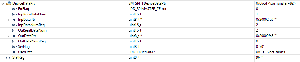

At the same time the device data structure of the SPI component is this:
So for me it seems, everything is transferred the right way (also confirmed by logic analyzer) but afterwards something happens?

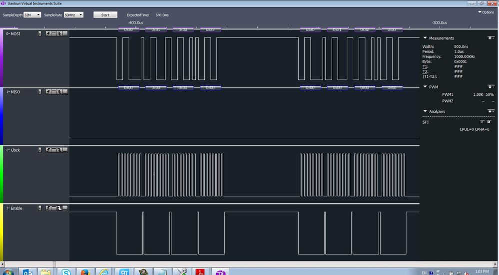

As you asked, here is a plot of the communication:
You can see the deadlock on the right side where the CS signal will not be released because of this (CS is controlled by software).

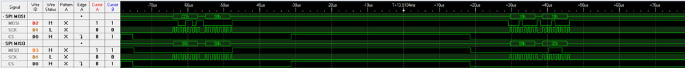

  Following is my test wave, I didn't connect the slaver, because you said your master have problem:
Attached is my test project, you can use it can check whether it blocks on your side, I test it on our TRK-KEA128 board.
