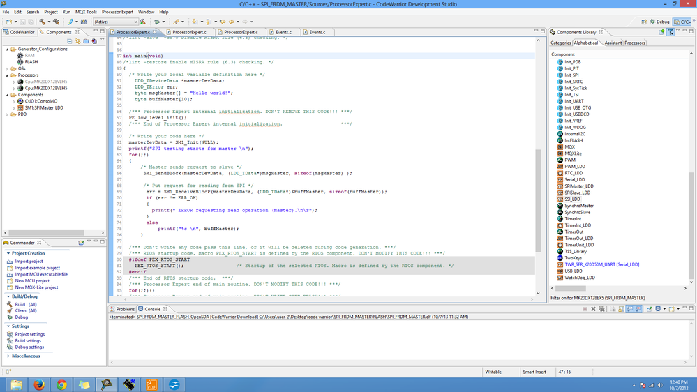

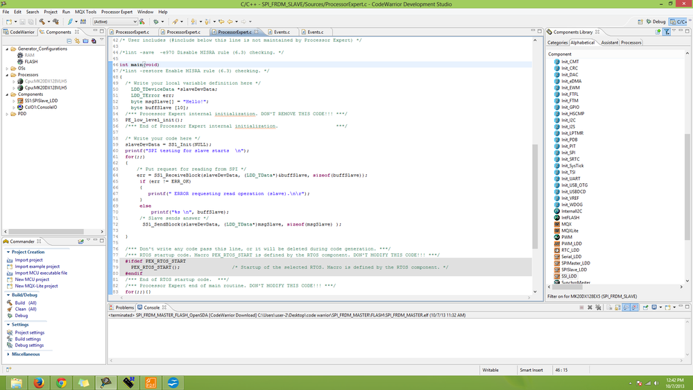

I am having problem in transmitting and receiving any character on this FRDM-K20D50M boards. I am using Codewarrior 10.4 with processor expert. I have configured the pins according to the following configuration using processor expert. I am Transmitting and receiving data on both the boards and displaying it on UART. The board configuration is as follows.
code for master controller:-
code for slave :-
The device is configured by processor expert and at any other file apart from this no changes is done. When connecting to the serial port in both the boards the error syntax ie ERROR requesting read operation (slave)  for slave and when connecting to master ERROR requesting read operation (master) is being displayed. which shows that the device is not able to read the data from SPI. Kindly look into the matter.

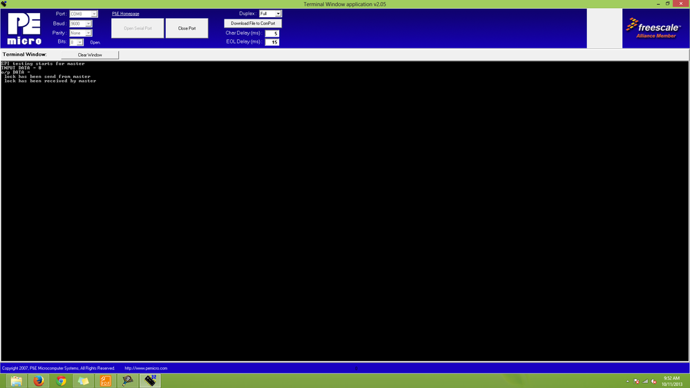

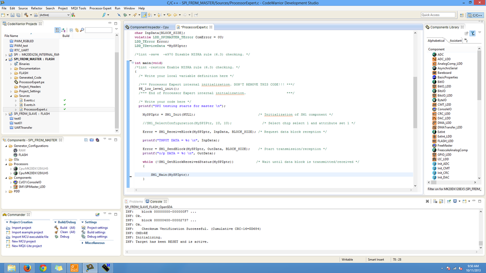

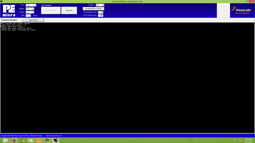

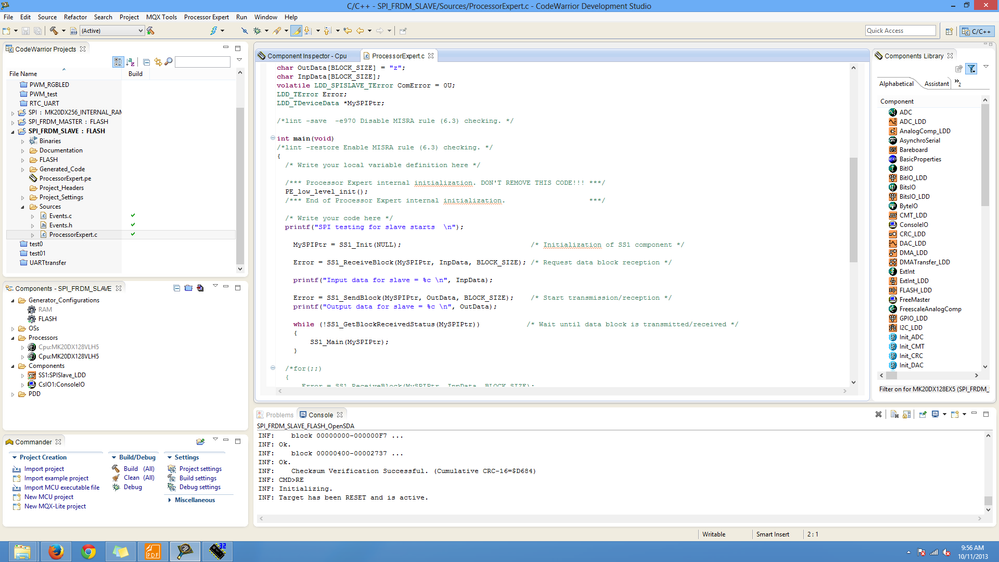

I have also tried the code present on the help of the component selector without interrupt and with same configuration which is suggested in the help. but after executing the command for master value 8 is being displayed and for slave value 4 is being displayed. Even if i change the integer value to character still I am getting the same result. Kindly look into the matter.
for master
output is
     for Slave
output is
Amit Kumar

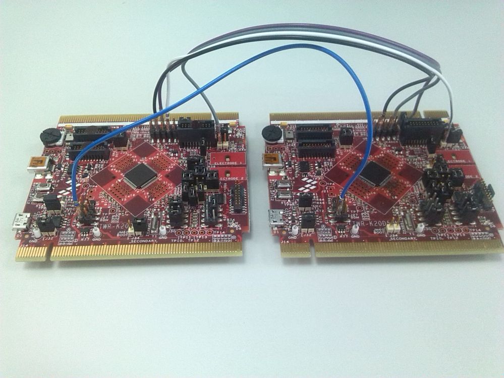

I am using two TWR-K20D50M boards test SPI communication with CW V10.4 Processor Expert tool generated project, which works on my side.
Please check my attached example code.
And the SPI pins connection between two TWR-K20D50M board is below:
TWR-K20D50M(SPI Master)          TWR-K20D50M(SPI Slave)
J2-3 (PTC5    SPI0_SCK)              J2-3 (PTC5    SPI0_SCK)
J2-6 (PTC0    SPI0_PCS4)            J1-2 (PTC4    SPI0_PCS0/SS)
J2-7 (PTC6    SPI0_SOUT)            J7-1 (PTC7    SPI0_SIN)
J7-1 (PTC7    SPI0_SIN)                J2-7 (PTC6    SPI0_SOUT)
J27-2 (GND)                                  J27-2 (GND)
Wish it helps.
Ma Hui

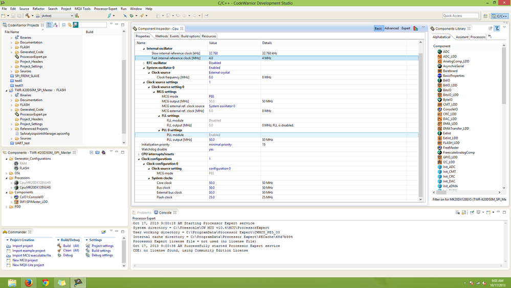

The below figure shows the clock setting in your Code which you posted
the below screenshot shows the clock settings for the code which I am dumping in the FRDM board
Did u meant external xtal ? but in both the boards the external crystal is of 8Mhz. connected on XTAL0 and EXTAL0 pins.
I am attaching my code also.
Amit Kumar

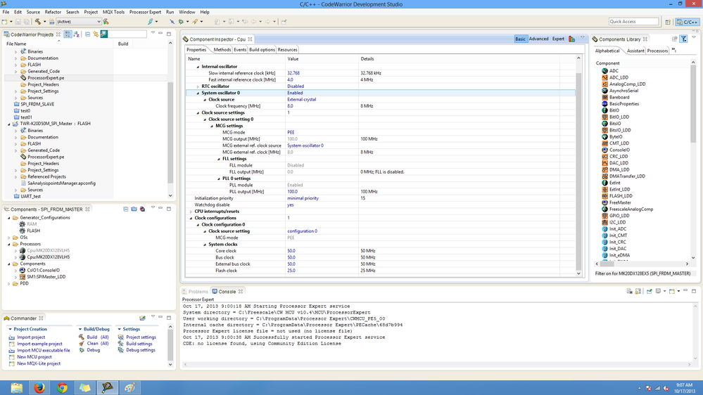

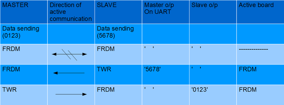

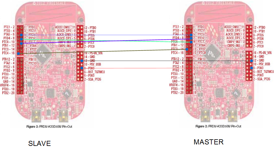

Thanks a lot for your reply it was really helpful. although the problem is not completely resolved but some progress is there. Actually I am having two FRDM-K20D50M and one TWR-K20D50M board so I tried your solution. The result was that when I connected two FRDM boards, No output was displayed. instead of data only spaces was displayed. And when I connected 1 FRDM and 1 TWR board board in different configurations, I observed that data was being transmitted from the TWR to FRDM board only. the reception was not being done through the TWR board.
I did all the connections in PTC when I tried to configure PTD in FRDM board as a master and TWR board as a slave then instead of getting '5678' I was receiving '3sdn'. I think the problem is with the transmission of data from the FRDM board. In the below figure , All the communication was supposed to be bidirectional but I have indicated the active flow of data which I received. Kindly look into the matter.
Best Regards
Amit Kumar
8,410 Views
egoodii
Senior Contributor III
I have never used Kinetis SPI in 'slave' mode (nor have I used Codewarrior or PE), but Victor's general comments about SPI are very important:
Every SPI transaction consists of a simultaneous TX and RX of one item (byte to word, length is set).  I would assume a slave would have to be 'preconfigured' with an item to TX, so that when the master's CS (and clock!) comes along, it is ready to send (and simultaneously receive).  You have to be ready at both the master and slave to handle one input and one output transaction per item, regardless of whether 'you need them or not'.  The Kinetis DSPI has some FIFOs that can help decouple 'service time' from line-time, but of course be aware that this further shifts the 'outgoing item sequence' from the 'incoming', for whatever you are trying to interchange.
PS -- your 'IN' and 'OUT' names above look wrong, but the diagrammed interconnect looks OK.

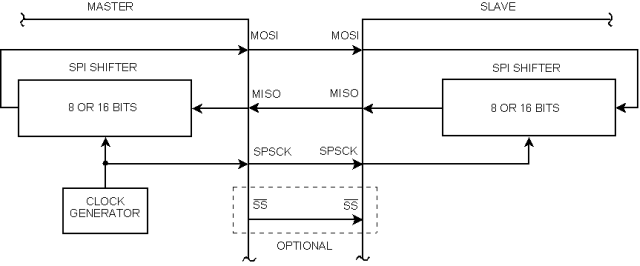

Hi Amit,
SPI silicon IPs work differently from those of the serial ports. In SPI writes and reads occur according to one CLK signal, this signal must be generated by the Master device. It's odd, but needed, you have to 'write' for 'reading', but only in the master device.
In the code for the master device, after writing, you have to keep checking wheter it is busy or not before trying to read:
  1. WriteBlock();
  2. while (busy()) { do something or nothing };
  3. ReadBlock( n bytes );
  4. call inmediately WriteBlock( same n bytes ); for generating the clock, it doesn't matter what you send.
One more thing, take into account the time it takes to the slave device to be ready to return data, it must setup the SPI driver before the master calls for return data. In some cases you could use one HW handshake signal to make the master aware of data availability in the slave device (one interrupt line).
There's a thread where you'll find some info about several issues with the SPI master drivers: Is anyone really using PE Generated SPI driver with MQXLite? How?.
Hope it's usefull for you.
--Victor

while going through SPI_LDD help i found the following connection diagram. I am wondering whether my above connection is correct or wrong?
Amit Kumar
8,411 Views
