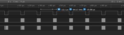

This is the output showing 11 bytes sent 64000 times a second:
Closer look:
Some notes:
It is not absolutely necessary to use a DMA completion interrupt since the PIT interrupt can simply configure everything needed each time it starts the transfer.
It IS IMPORTANT to clear the EOQF flag in the status register otherwise it will not transmit a second time.
There is no need to enable and disable the SPI since if the DMA is not active it won't send anything anyway.
Although only a detail it is not recommended to clear flags with
SPI0_SR  |= SPI_SR_EOQF_MASK | SPI_SR_TCF_MASK | SPI_SR_RFDF_MASK | SPI_SR_TFFF_MASK | SPI_SR_RFDF_MASK
but correctly they should be cleared with (not ORing with what is read)
SPI0_SR  = SPI_SR_EOQF_MASK | SPI_SR_TCF_MASK | SPI_SR_RFDF_MASK | SPI_SR_TFFF_MASK | SPI_SR_RFDF_MASK
Although the DMA API you are using needs a lot of careful setup (and error prone due to this) I didn't actually spot anything that was incorrectly configured. Therefore check that the EOQF clear is not somehow being optimised away and try not disabling/enabling the SPI between transfers.

#define SPI_DMA_LENGTH    11
#define SPI_DMA_CHANNEL   7
// PIT 0 interrupt callback
static __callback_interrupt void _startTx(void)
    static unsigned long ulSPI_TxBuffer[SPI_DMA_LENGTH] = {0};           // tx buffer
    unsigned char ucByteValue = (unsigned char)ulSPI_TxBuffer[0];
    WRITE_ONE_TO_CLEAR(SPI1_SR, (SPI_SR_EOQF));                          // clear the end of queue flag
    while (i < (SPI_DMA_LENGTH - 1)) {                                   // prepare a tx data pattern
        ulSPI_TxBuffer[i++] = (SPI_PUSHR_CONT | SPI_PUSHR_CTAS_CTAR0 | SPI_PUSHR_PCS0 | ++ucByteValue);
    ulSPI_TxBuffer[i] = (SPI_PUSHR_EOQ | SPI_PUSHR_CTAS_CTAR0 | SPI_PUSHR_PCS0 | ++ucByteValue); // negate CS line after final bytes is sent
    // Configure Tx DMA (buffer to SPI, single buffer with no interrupt on termination)
    fnConfigDMA_buffer(SPI_DMA_CHANNEL, DMAMUX0_CHCFG_SOURCE_SPI1_TX, sizeof(ulSPI_TxBuffer), &ulSPI_TxBuffer[0], (void *)SPI1_PUSHR_ADDR, (DMA_LONG_WORDS | DMA_DIRECTION_OUTPUT | DMA_SINGLE_CYCLE), 0, PRIORITY_DMA10);
    fnDMA_BufferReset(SPI_DMA_CHANNEL, DMA_BUFFER_START);                // start the transfer
// PIT and SPI configuration
static void fnConfigurePIT_SPI(void)
    PIT_SETUP pit_setup;                                                 // PIT interrupt configuration parameters
    // Configure SPI
    POWER_UP_ATOMIC(6, SPI1);
    _CONFIG_PERIPHERAL(D, 4, (PD_4_SPI1_PCS0 | PORT_SRE_FAST | PORT_DSE_HIGH));
    _CONFIG_PERIPHERAL(D, 5, (PD_5_SPI1_SCK | PORT_SRE_FAST | PORT_DSE_HIGH));
    _CONFIG_PERIPHERAL(D, 7, (PD_7_SPI1_SIN | PORT_SRE_FAST | PORT_DSE_HIGH));
    _CONFIG_PERIPHERAL(D, 6, (PD_6_SPI1_SOUT));
    SPI1_MCR = (SPI_MCR_MSTR | SPI_MCR_DCONF_SPI | SPI_MCR_CLR_RXF | SPI_MCR_CLR_TXF | SPI_MCR_PCSIS_CS0 | SPI_MCR_PCSIS_CS1 | SPI_MCR_PCSIS_CS2 | SPI_MCR_PCSIS_CS3 | SPI_MCR_PCSIS_CS4 | SPI_MCR_PCSIS_CS5);
    SPI1_CTAR0 = (SPI_CTAR_DBR | SPI_CTAR_FMSZ_8 | SPI_CTAR_PDT_7 | SPI_CTAR_BR_2);
    SPI1_RSER = (SPI_SRER_TFFF_DIRS | SPI_SRER_TFFF_RE);                 // enable DMA request when tx fifo not full
    pit_setup.int_type = PIT_INTERRUPT;
    pit_setup.mode = PIT_PERIODIC;                                       // PIT periodic interrupt
    pit_setup.ucPIT = 0;                                                 // use PIT0
    pit_setup.int_handler = _startTx;                                    // PIT interrupt callback
    pit_setup.int_priority = PIT0_INTERRUPT_PRIORITY;
    pit_setup.count_delay = PIT_FREERUN_FREQ(64000);                     // 64kHz interrupt rate
    fnConfigureInterrupt((void *)&pit_setup);                            // configure and start the PIT
Closer look:
Some notes:
