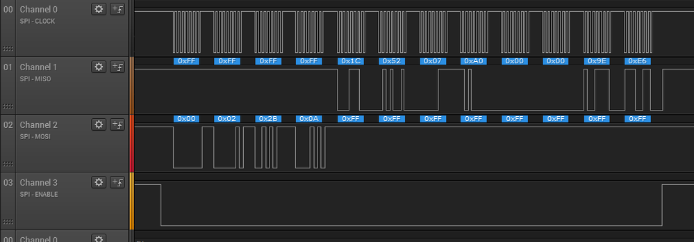

Hello Everyone,
I am using the KEA128 controller in one of my projects which requires communication over the SPI bus with CPOL=1 and CPHA=1. I've configured the SPI like shown below. However, i am not sure about the CPHA setting for SPI MODE3
   /* initialize SPI0 as master    */
    sSPIConfig.u32BitRate = SPI_BIT_RATE;  //1000000 - 1 MHz
    sSPIConfig.u32BusClkHz = BUS_CLK_HZ;  // 20000000 - Internal Clk Oscillator - 20.97 MHz
    sSPIConfig.sSettings.bModuleEn             = 1;
    sSPIConfig.sSettings.bMasterMode           = 1;
    sSPIConfig.sSettings.bClkPhase1            = 1;
    sSPIConfig.sSettings.bClkPolarityLow       = 1;
    sSPIConfig.sSettings.bMasterAutoDriveSS    = 0;
My SPI read write functions are as below. I am using the SPI library provided in the KEA quickstart package.
I would like to know if the above settings and below operations would work in SPI MODE3 or not, as i am observing
that even though there is data on MISO, the SPI read operation returns 0xff. The read operation is shown below. The MISO line is pulled up on the SPI device side since its a open drain line.

So i figured the problem out. Apparently for this controller SPI0 MISO is also the NMI pin which needs to be switched to SPI MISO in the SOPT0 register...
SIM->SOPT0 &= ~SIM_SOPT0_NMIE_MASK
Problem solved...

    SPI0_MISO also can assigned in PTE2, you don't need to assign it to the NMI pin.
   Please set SIM_PINSEL0[SPI0PS]=1, then
SPI0_SCK, SPI0_MOSI, SPI0_MISO, and SPI0_PCS are mapped on PTE0, PTE1, PTE2, and PTE3.
Wish it helps you!
Kerry
3,717 Views
testbed
Fresh Out Contributor
Hello Kerry,
Thank You for the info. However, the board i designed has SPI0_MISO connected to PTB port pins. So no choice there, unless i revise the board design....
