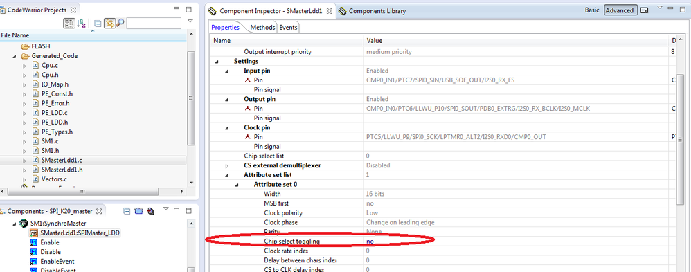

I have a peripheral which requires SPI CS "16 bit mode" and "turbo mode". In  turbo mode, the CS keep low for any number of bytes sending.
In PE, there are 16 bit mode, the SPI CS keep low during sending the 16 bit bytes, that is achievable.
But in PE  SPI "Attribute set" ==> width , there is no such "turbo mode". Does anyone knows how to achieve it?

I see that you use MK20DX128 and CW ver10.6 plus PE. If I understand you correctly, the so-called "turbo mode" is that the /SS of slave SPI is always low, in the case, I suggest you connect a GPIO pin of the master SPI to the /SS pin of the slave SPI, before you transfer data, clear the GPIO, it is okay.
If you do connect the PCSx of master SPI to the /SS pin of the slave spi, your idea is okay to be implemented, from SPI module, if you set the CONT bit(MSB) of SPIx_PUSHR, the PCS pin   will always be kept low even between the interval of two SPI transfer.
The PE support the feature, pls select "no" for the 'chip select toggling" as the following figure cut from PE bean.
But I do not think keep PCS low is  a good idea because SPI frame lose synchronization for each data.
Hope it can help you.

rabbitz
Hi Rong,
Thanks. It works now, I made a mistake for set the"Chip Select Toggling" to "YES".
Sam
