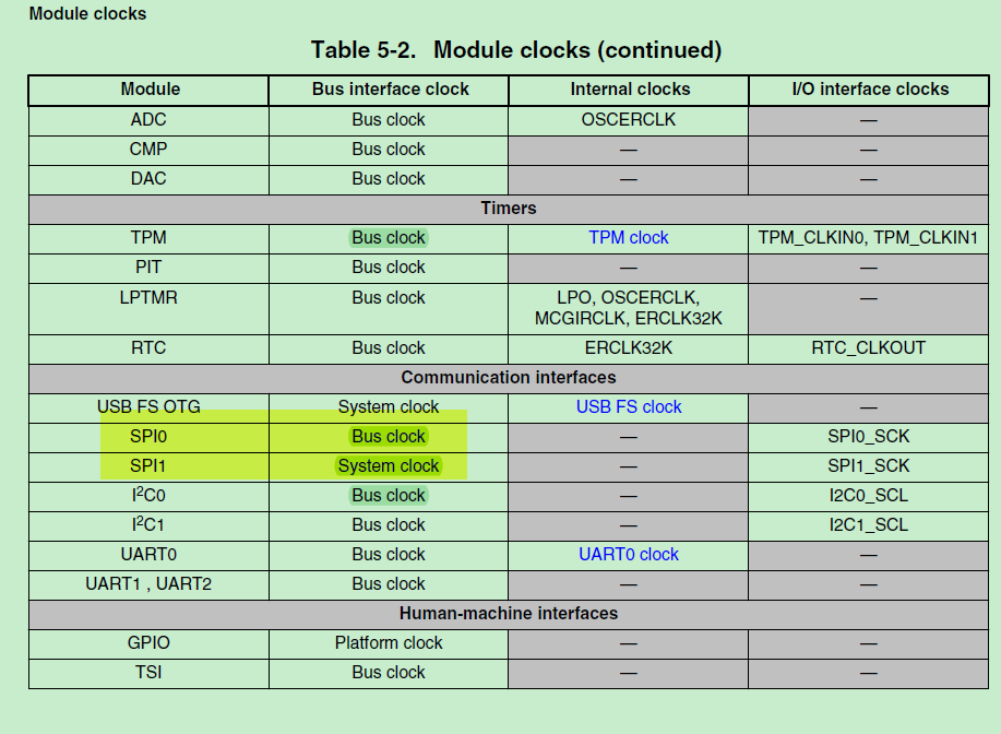

    You can use the SPI1, the clock source is the system clock, the system clock can up to 48Mhz, let's take system clock = 48Mhz as an example.

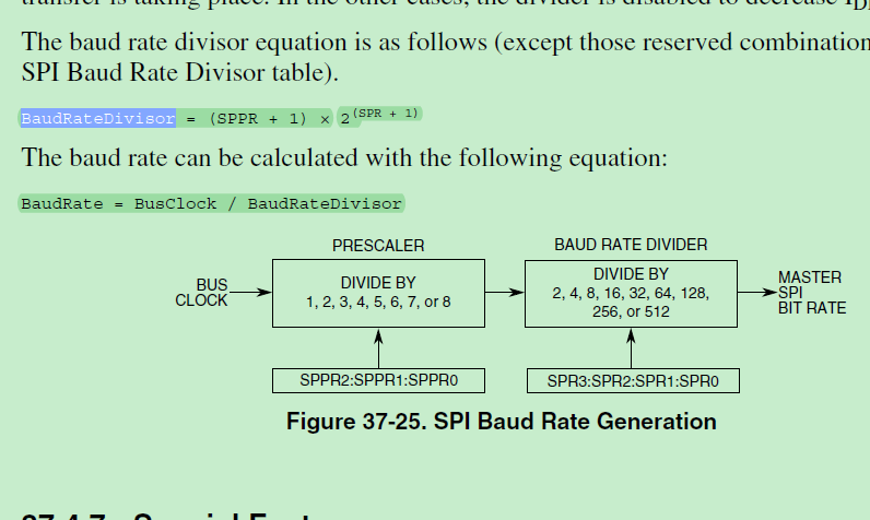

Now, follow this picture to calculate the SPPR and SPR.
8Mhz= 48M/(SPPR+1)*2^(SPR+1)
So, SPPR=2, SPR=0 can get 8Mhz baudrate.
You can configure SPI1_BR=0X20.
  If your bus is 24Mhz, you can't use the SPI0 get 8Mhz, SPI0 clock source is bus clock.
