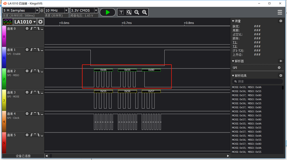

Right  SO sequence  should be 0x55 0x80 0xAA.
1.Master Power-on first:
1) error: 0xAA 0x55 0x80
2)error: 0xAA 0x55 0x80
2. SPI poweron first
1)error: 0x80 0xAA 0x55
2)right: 0x55 0x80 0xAA

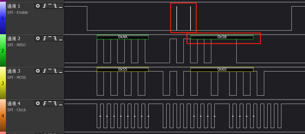

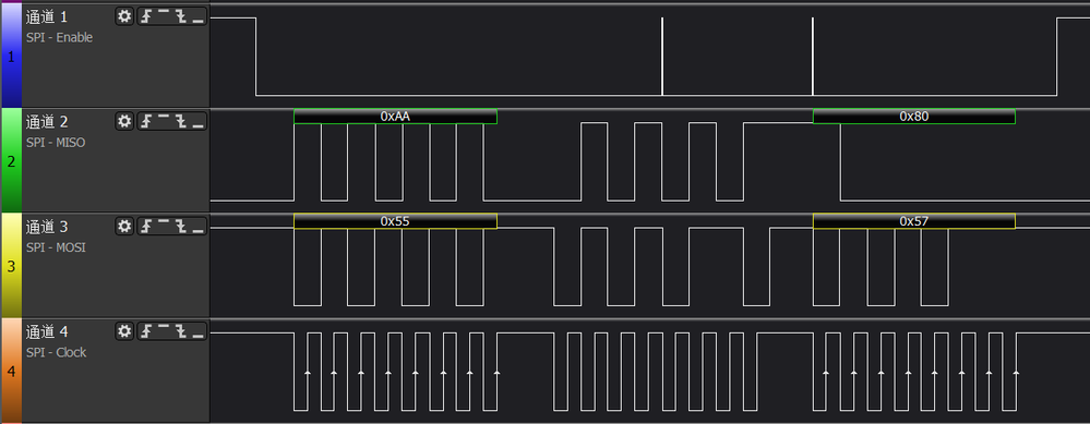

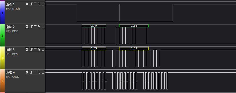

I change the slave's code and then try to power on slave first.
It seems that it does not work. But I find the CS(SPI Enable) is innormal, that is, the CS line will change to high level about 100ns sometimes and the go back to low level. Maybe it result in my SPI Slave frame's bytes absence and then error byte sequence.
The bytes absense does not happen every time.
Do you have met the same problem?
I doubt my connection is not very reliable by 4 dupont lines between two FRDM-KEA128Q80 evbs. I do not know whether there is a better method to recognize a SPI frame head & tail on Slave. So the master will ignore the invalid frame, and there is no other effect on next SPI frame.

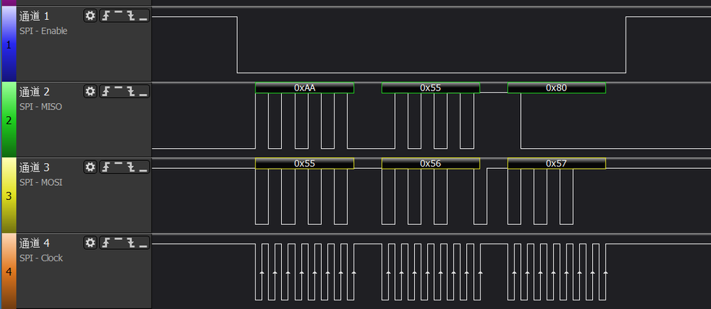

Result
4 different results.
1) error sequence: 0xAA 0x55 0x80
2) error: 1 byte absence, CS 0~1 keep 100nsSlavePowerOnFirst1.png
3) error: 2 byte absence, CS 0~1 keep 100ns/every timeSlavePowerOnFirst2.png
4) error: 2 byte absence, CS 0~1 keep 100ns/every timeSlavePowerOnFirst3.png
