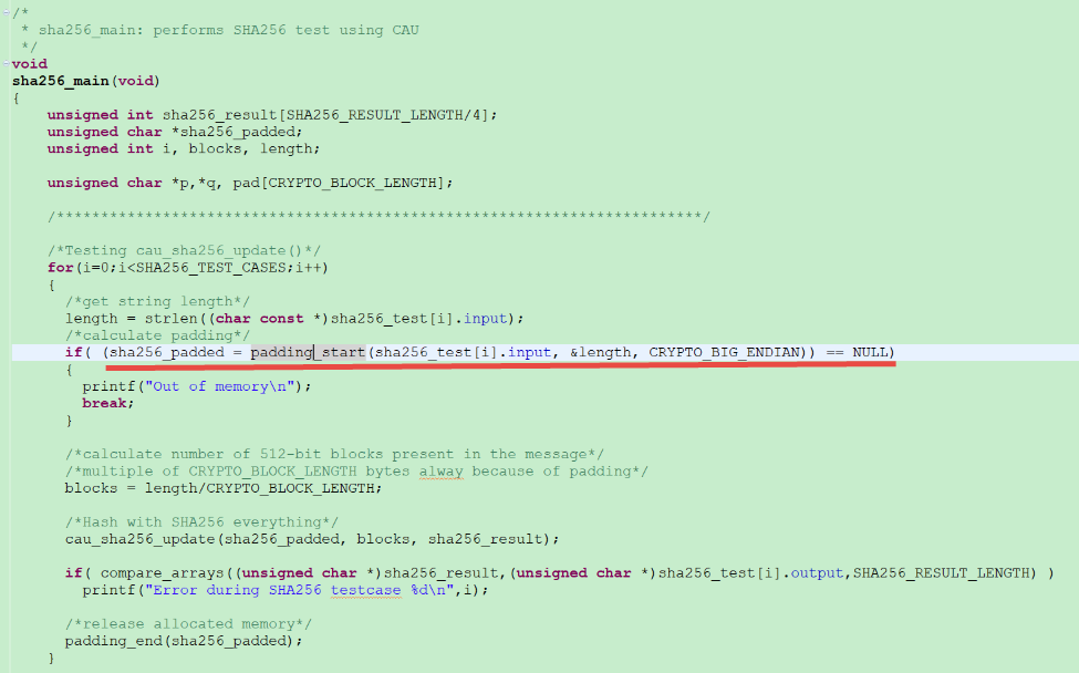

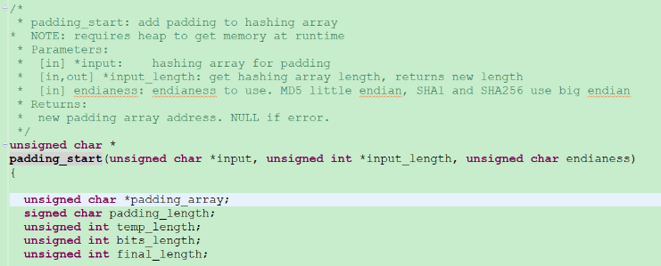

Hi Mark,
I got feedback from Kinetis product team.
There mentioned the AN4307 and related software AN4307SW for your reference.
The AN4307 indicates the hashing requires the padding, I checked the SHA256 hash calculation demo of MCF54418 chip calling  padding_start() function before calculation. The software project embedded in AN4307SW package.
I attached the padding_start() function below for your reference:
SHA256 test code:
padding_start() API function:
Wish it helps.

Many thanks Mike
Now it works:
0xff 0xe0 0x54 0xfe 0x7a 0xe0 0xcb 0x6d 0xc6 0x5c 0x3a 0xf9 0xb6 0x1d 0x52 0x09 0xf4 0x39 0x85 0x1d 0xb4 0x3d 0x0b 0xa5 0x99 0x73 0x37 0xdf 0x15 0x46 0x68 0xeb
I note that:
1. When you tested you seem to have prepared padding but called MMCAU_SHA256_Update() with the wrong block length (i.e. 1) - it needs to be 2 (to include the padding block). I had the same results before I realised this...
2. In the guide https://www.nxp.com/docs/en/user-guide/CAUAPIUG.pdf (which is the document linked to on the Kinetis pages) this requirement is not discussed anywhere and so doesn't allow the API to be used without additional knowledge (and additional code)
3. It may make sense to merge https://www.nxp.com/docs/en/application-note/AN4307.pdf  and https://www.nxp.com/docs/en/user-guide/CAUAPIUG.pdf  in some way so that the are complete.
4. Another thing that the https://www.nxp.com/docs/en/user-guide/CAUAPIUG.pdf doesn't state is that the output (which has the correct values if the padding block is prepared) is in big-endian (stored as long words) and so a big-endian to little-endian conversion also needs to be added at the end (this is mentioned in the application note).
