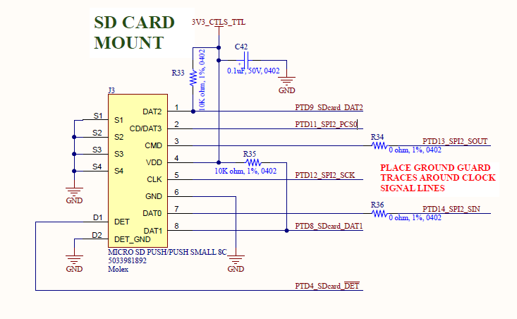

I am new to SD SPI, using ELM_CHAN FatFs with fsl_sdspi, interfacing with a MicroSD card.  Can anyone help figure out why I'm getting kStatus_SDSPI_ResponseError.
Traceback:
K8x_FatFS_demo JLink Debug [GDB SEGGER Interface Debugging]
 K8x_FatFS_demo.axf
 Thread #1 57005 (Suspended : Breakpoint)
 SDSPI_SendCommand() at fsl_sdspi.c:373 0x7d8
 SDSPI_GoIdle() at fsl_sdspi.c:425 0x8d0
 SDSPI_Init() at fsl_sdspi.c:1,091 0x1674
 sdspi_disk_initialize() at fsl_sdspi_disk.c:171 0x198e
 disk_initialize() at diskio.c:127 0x5110
 main() at FatFSdemo.c:50 0x528

deniscollis
Contributor V
The MicroSD slot pinouts were wired incorrectly to the MCU!  The physical board did not match the schematic!

deniscollis
Contributor V
Thanks for that Sabina.
It looks like it may be a hardware design fault.  I immediately noticed that the circuit design in the document that you referenced is quite different.  It has PULL-DOWN resistors on DAT1 and DAT2 signals...
...while manufacturer's specify pull-ups, like this one from Kingston:
Mine has PULL-UP resistors on DAT1 and DAT2 only, and no pull-ups on any on the SPI signals at all, and so relies on the K8I's internal pad pull-ups instead.  I also notice from your reference document that the pull-ups/downs are quite strong – 10KΩ, while my pull-ups are much weaker –  100KΩ for the external pull-ups, and I think the K8x internal pull-ups are somewhere in-between – 47KΩ.
This is what happens electrically;
With and SD card inserted, if I apply the K8x pad pull-ups, with no VDD present, then the card keeps all SPI signals low.  When VDD is applied, the card releases CS, CK and  MISO, and they immediately go high, but MOSI appears to remain driven low by the SD card.

deniscollis
Contributor V
Looks like it was a hardware issue - the internal pull-ups may not be strong enough. I soldered some 10K pull-ups on:
  • CMD/DI - SPI_MOSI
  • DAT0/DO - SPI_MISO
  • DAT3/CS - SPI_CS.
  • DAT1 & DAT2
Now, all the pins, including MISO, are at the correct levels.
