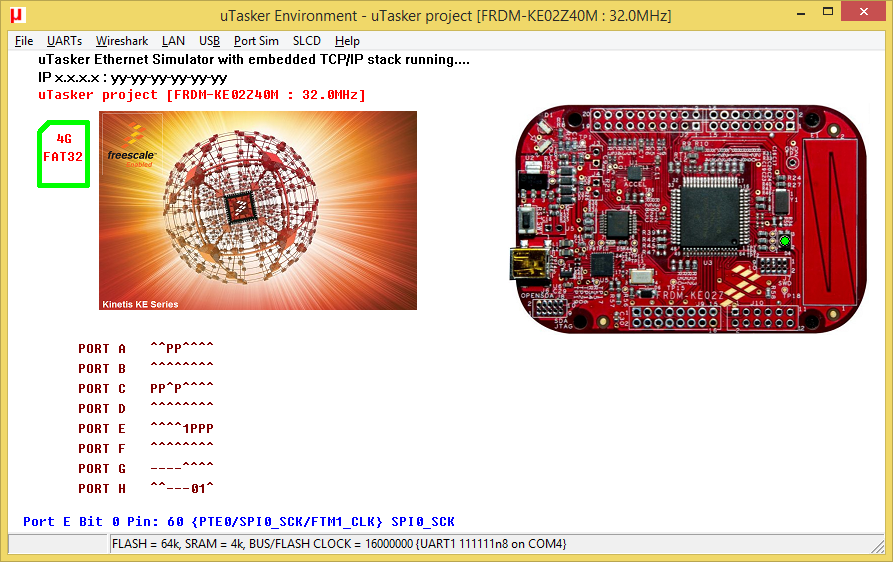

mjbcswitzerland
Specialist V
I have attached binary files for FRDM-KE02Z40M and FRDM-KE02Z and SD card (build with KDS and GCC).
In both cases the SD card can be connected using the following pins:
        // - SPI0_CS  PTE-3 (J9-7) [VDD J9-4 / 0V J9-14]
        // - SPI0_SCK  PTE-0 (J9-1)
        // - SPI0_MOSI PTE-1 (J9-3)
        // - SPI0_MISO PTE-2 (J9-5)
There is a DOS-like interface on the OpenSDA virtual COM port UART which allows the SD card to be manipulated. Eg.

D:\>dir
Directory D:\
---- 26.10.2015  12:00 <DIR>            dir1
---A 26.10.2015  12:00              256 M21.txt
1 files with 256 bytes
1 directories, 4115939328 bytes free
This is available at http://www.utasker.com/kinetis.html and will work on most Kinetis parts and IDEs without needing any porting effort. utFAT documentation at http://www.utasker.com/docs/uTasker/uTasker_utFAT.PDF
and the project, processor and SD card can be simulated in (approx.) real time as shown below.
Mark
