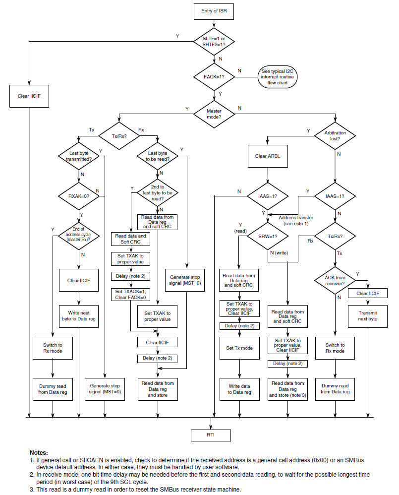

Hi Giovanni,
we have had some internal discussion regarding to the issue of locked SCL after FACK = 1 etc.
There is light difference between the I2C modules on KL17 with 128/256k flash and KL17 with 32/64k flash. And it looks like we have not proper flow chart in reference manual of KL17 with 128/256k flash (we have had proper one in past revisions, after newer revisions we accidentaly change it in wrong way). Please, if you use device with 128/256k flash then you will need to follow this flow chart for FACK = 1:
The difference is in write sequence of slave where delay + second read of IICD is required to be added. Please, let us know if this helped. Thanks for understanding.

Hi Rastislav Pavlanin,
Thanks for the correction. However, as I stated previously, I never enter the ISR. So a modification to my ISR unfortunately doesn't change a thing. I think there is additional information that I'm lacking (or did not detect).
For example, the SMBus ISR flowchart does not show how to handle Start bit detection and Stop bit detection. I could assume this is because this 'low level' part of the SMBus ISR is depicted in the typical I2C ISR. The flowchart points this way when the FACK bit is '0'.
However, it is not indicated when one would change the value of the FACK bit. So if this is set once, e.g. at initialization (as is the case in my trial code), "FACK='1'?" is always true, in which case the SMBus flow chart does not refer to the typical I2C ISR flowchart anymore. Is it necessary to modify the FACK bit at any point?

By the way, did you fully followed the diagram for SMBus routines? (Typical I2C SMBus interrupt routine)

Indeed, the pdf posted on that thread only shows interrupts after acknowledging (9th clock pulse), while the interrupt with FACK set to '1' comes after the 8th clock pulse, before acknowledging.
I am not very familiar with SMBUS implementation either, as it is not my goal to implement SMBUS. I only want to use the 'manual' acknowledging. As for following the SMBus IRQ diagram, I did make the modifications to line up with the SMBus interrupt routine as far as the slave portion is concerned. However, as the controller never enters the ISR, I guess it doesn't matter whether I followed it or not so far.
