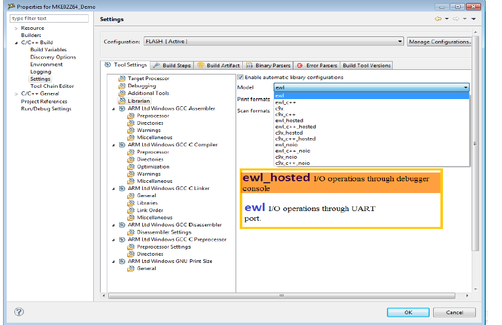

kerryzhou
Hi Ian,
  What the IDE you are using? And where the code you are downloading, Flash or RAM?
  You must make sure your code is downloaded to the flash not the RAM.
  Then if you still have the problem, and you also use the CW, please check this picture:
Properties should select ewl_hosted in Librarian.
Wish it helps you!
Kerry
