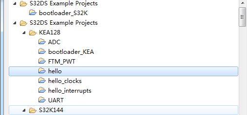

hi Alice:

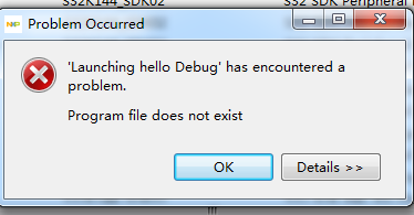

              我的步骤是采用S32DS的自带工程,步骤如下:板子采用官方的TRK-KEAZ128,我用官方的keil工程是可以下载的。S32DS不行

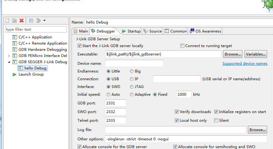

pastedImage_4.png无法选择器件
5,717件の閲覧回数
Hi Haifeng,

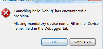

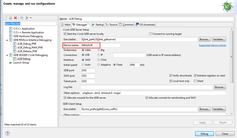

Please add Device name :  SKEAZ128 pastedImage_1.png

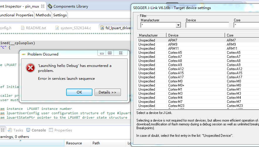

haifengjin
hi  Alice:
               填上之后出现如下错误:
5,717件の閲覧回数

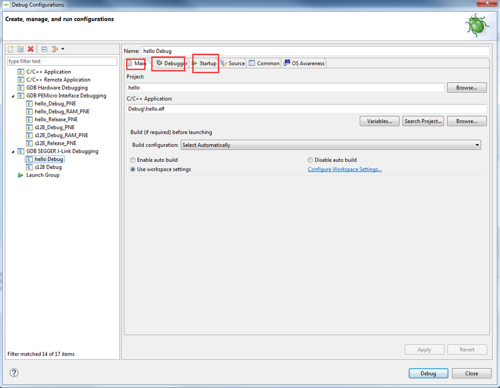

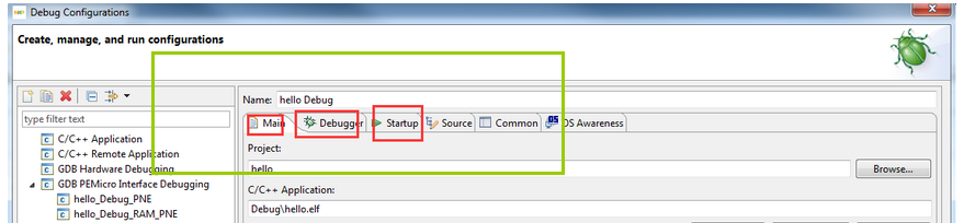

Please show the three views I point below:
Also please change to a new workspace to try.
Alice

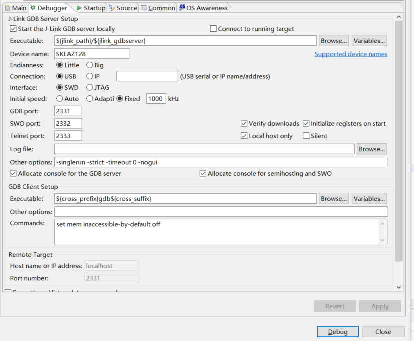

haifengjin
hi

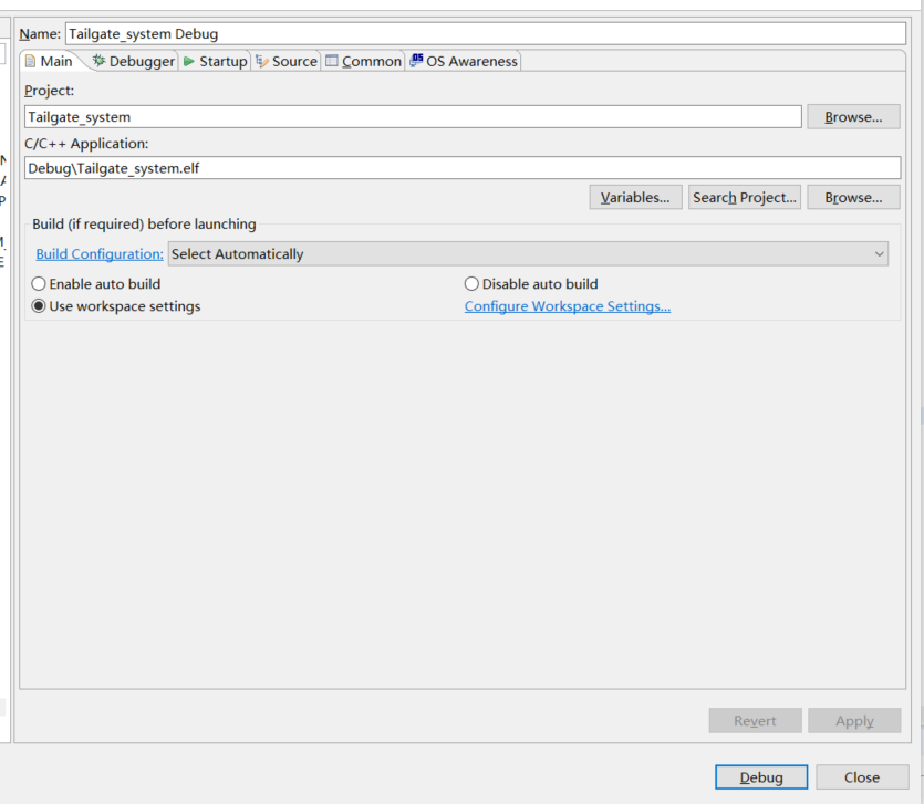

           按照你的提示,选上elf,选上device,但是还是会报错:
5,717件の閲覧回数
Dear Haifeng,
1. In your screenshot , sorry I can't see which device you choose.
2. Also you haven't show the three view I mentiond:
3. Could you please take a video show your steps in detail, thanks!
Alice

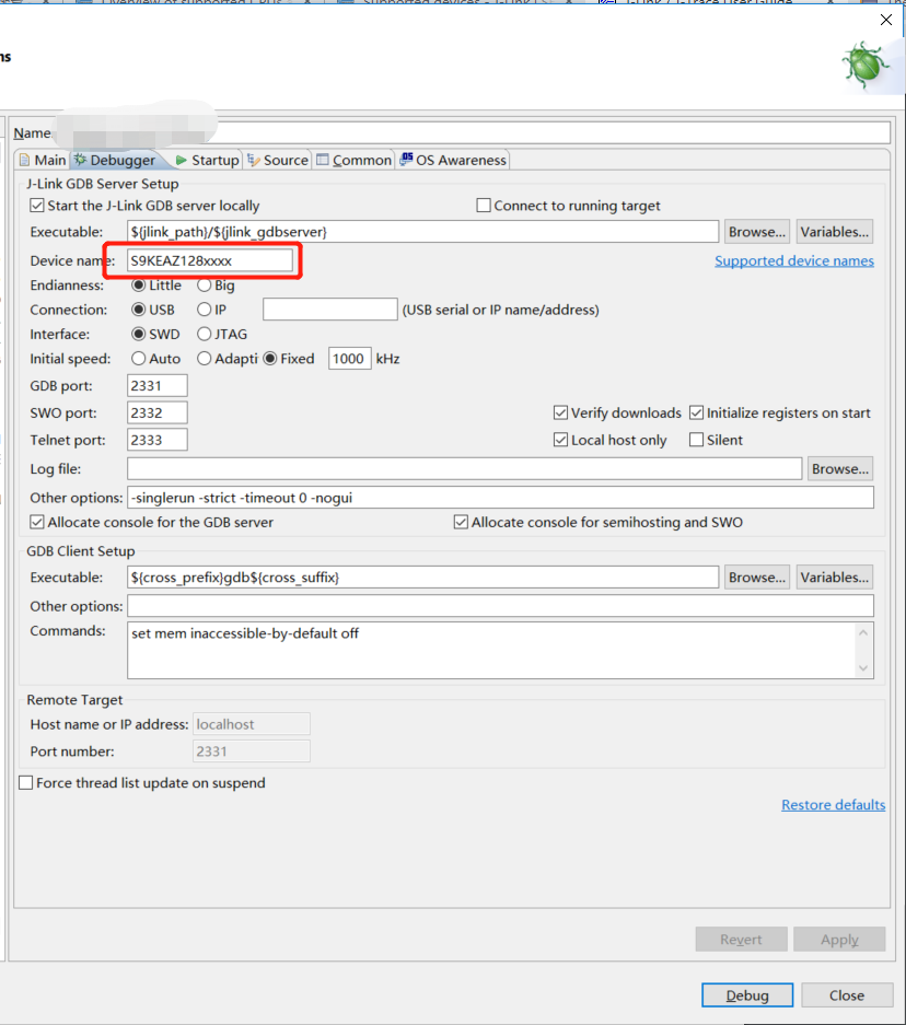

elder_atom
Dear Alice_Yang
    I meet the same question while I add the device name: SKEAZ128. Please help me solve this issue.
Thx!
5,717件の閲覧回数
elder_atom
Choose the right device name, and it works.
Thx everyone who shared the experience.
