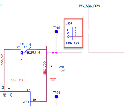

I'm using S32 Design Studio for ARM 2.2 and I have an application running well in P&E Release mode.  However it appears I cannot run the app separately from the debugger even if it is independently powered.
Is there something else I need to do before it can run independently?

tomsparks
Felipe:
Yes, I am doing exactly as you describe.
Thank you,
Tom

FelipeGarcia
Hi Tom,
If you are using rev. B of the board you need to select the voltage to use through J107 jumper.
Felipe

FelipeGarcia
Hi Tom,
If I am understanding correctly you loaded an application using OpenSDA through J7. Then, you disconnected J7 and powered the board through 12V external power port through J16.
After you did this the application does not run, am I correct? Please make sure you are using only one power supply, not both.
