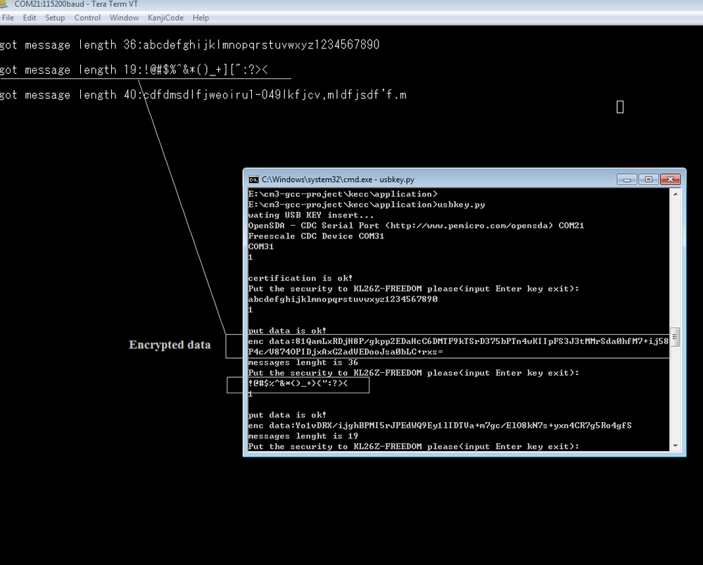

     This example implements a simple ECC certification from PC to USB.  After certification,
    USB can get encrypted data from PC and decrypt these data to plain text.

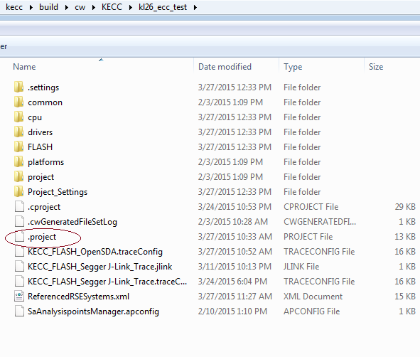

KL26-Freedom :

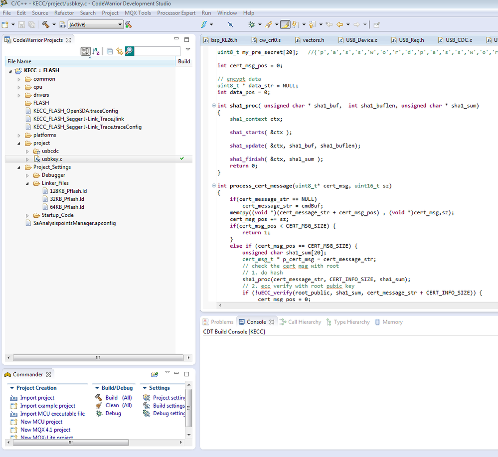

1.   Open the porject file at folder kecc/build/cw/KECC/kl26_ecc/test
2.  Build the image and flush it with OpenSDA.

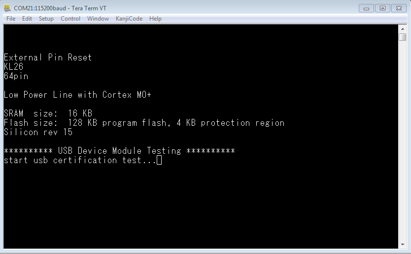

3. Open the Tera Term and start running image on KL26Z

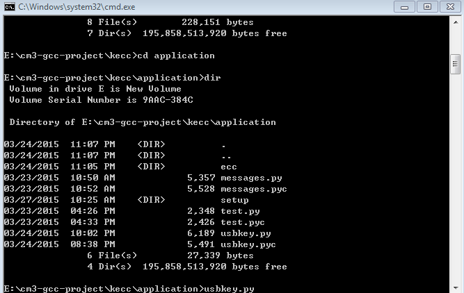

PC running environment:

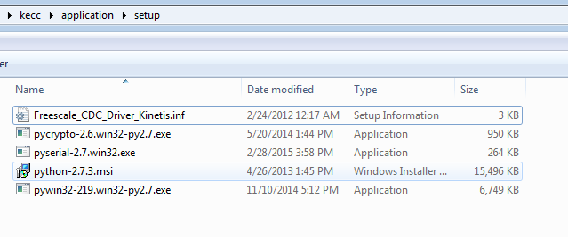

  1. Install  these packets on PC:
        python-2.7.3.msi, pycrypto-2.6.win32-py2.7.exe, pyserial-2.7.win32.exe and pywin32-219.win32-py2.7

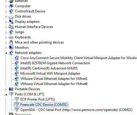

  2. Connect USB cable to KL26Z Freedom and install the CDC driver with
      Freescale_CDC_Driver_Kinetis.inf driver

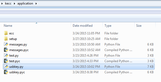

3. Open the application folder and run the usbkey.py.
    4. If USB admits  PC certification message, then PC can put encrypted data to USB.
    This  demo only tested on WIN7 64bit. IF you can't
open the CDC port, you need reset the KL26Z freedom board and restart the
usbkey.py.
