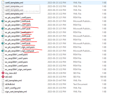

I'm uisng SDK verison 2.12.7, I have integrated otap_client example to my project using application developers guide. Bluethooth connection works fine for us, I can see my device in the NXP toolbox application, I can download whole application into the mentioned flash location.
For generating new signed image, I have used Over the air Programming application, I'm using old root certificates files (generated by using SPSDK python files, OEM keys and certificate, for your reference please refer to attached image) which we have generated to burn the fuses at the time of flashing BLE firmware provided by NXP.
I have also found FW update status in OTACFG register, it is returning 0x4412d283 at location 0x02006020, it indicates failure to process sb3 file or failure to erase/write update status to OTACFG page.

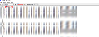

Hi, I'm facing one more issue, I have sdk SDK_2_12_7_KW45B41Z82xxxA and we found out new ble controller binary kw45b41_nbu_ble_1_9_12_3.xip file, I have generated the sb3 file out of it because I'm using our own pcb and keys and certs, I can successfully flash generated sb3 via blhost utility, but when I flash application code through MCuxpresso debugger, application code is going to fault state, please refer the below image
and when I revert to old sb3 file(this was also generated a year ago using this kw45b41_nbu_ble_1_9_10_0.xip verison), this fault is not coming, code runs fine.
