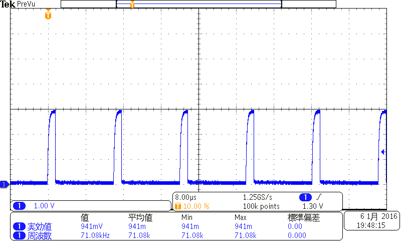

I made custom boards using MK64FN1M0VLQ12 (144pin).
I received boards from integration company, adn I tried to write my software to the board by the P&E Micro Multilink Universal with the PROGACMP.
I push a Connect(Reset) button, then I got a dialog message of "Device is secure. Erase to unsecure?"
I checked reset pin of MK64, I saw a strange waveform.
Here is my questions.
1. When any firmwares  are not written  to the MK64 ever, is this signal correct?
2. How should I do for writing firmware to MK64?

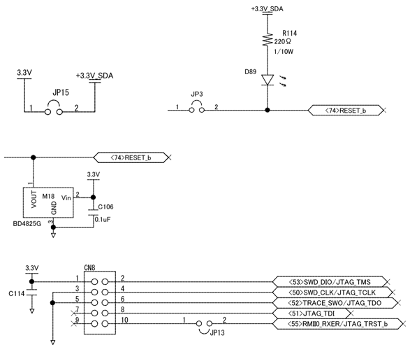

This is a schematic of my custom boards around riset pin and the debug interface.
If you have any idea, please let me know.

cutworth
Hi Matsuzaki San,
Do you have a J-Link debugger on hand? If using PEMicro Debugger shows MCU secured, maybe it's really secured when you connected JTAG-TRST instead MCU reset. You can try connect with J-Link and use it to unlock Kinetis MCU.

kiyoshimatsuzak
I couldn't resolve this issue.
I checked RESET signal when I connected to the K64 using P&E micro's PROGACMP.
When I push "Connect (Reset)" button, RESET signal became low, then I got a dialog of "Device is secure. ...." , and  RESET signal was still low.
After I clicked Yes/No button on dialog, RESET signal became the waveform which I attached above.
I think that RESET signal has to be high.
Where should I check?
Kiyoshi Matsuzaki

The RESET pin waveform is normal with device whose flash is empty. MCU core will try to fetch instructions from flash and when it's empty, it will enter exception and then reset continuously. So what you see is normal.
Then for your problem, your schematic is incorrect. The JTAG connector pin 10 should be connected to MCU reset pin instead of JTAG_TRST reset.
You can check attached J-Link debugger document page 398 for detail.

kiyoshimatsuzak
Hi, Hao
Thank you for your reply!
I could understand that the waveform is normal, thank you so mutch!
And as you say, I connected pin9 to RESET of K64.
Then I tried to connect using the Multilink Universal.
But I couldn't connect yet.
Do I have to set any pullup(s) at pin9 (or others)?
If I have to check any other points, please let me know.
