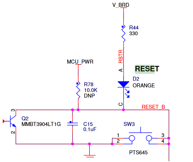

When power is initially applied to the MCU or when the supply voltage drops below the power-on reset re-arm voltage level (VPOR), the POR circuit causes a POR reset condition. As the supply voltage rises, the LVD circuit holds the MCU in reset until the supply has risen above the LVD low threshold (VLVDL).
If no external circuits are added then the reset may have issues. You can add a pull up circuit like this one with the resister and capacitor:
It would be helpful if you attach your schematic so I can help you better.

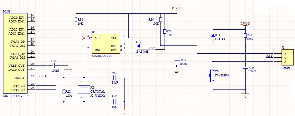

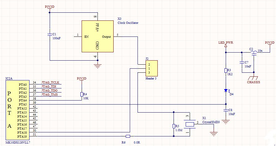

As external circuits, I put my schematics below for your reference.
Two Reset Circuits to check which one is OK. To do that, a Jumper link will be put on J5.
Neither did work when a Jumper link was put on. I meant voltage at /RST is 0.1v (link Pin 1 and Pin 2 of J5 ) after Power ON.Reset is 0v when Manual reset key press and 1v when reset key release (link Pin 1 and Pin 3 of J5) .  by the way, Pin 1 in schematics here is in the middle position of J5 at PCB. If without the jumper link, both Pin 2 and Pin 3 of J5 is 3.28v after Power on, and /RST is still logic low. I'm wondering if mass erase ever implementation make this kind of situation.
a Pullup resistor is at PTA4, which can be seen from below circuitry. and clock as well.

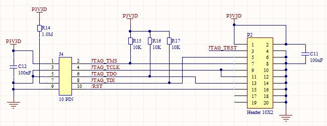

Below is JTAG connection.
Below is VDD and VSS connection.
That's it. the MK10DX128VLL7 soldering orientation and related PINs (VCC, GND, Rest, Oscillator) soldering quality are all checked. no shortage no void soldering.

The reset configuration with the pin 1 and 3 jumped are correct. I suggest you to place a capacitor to ground in the node where the R20 is located.

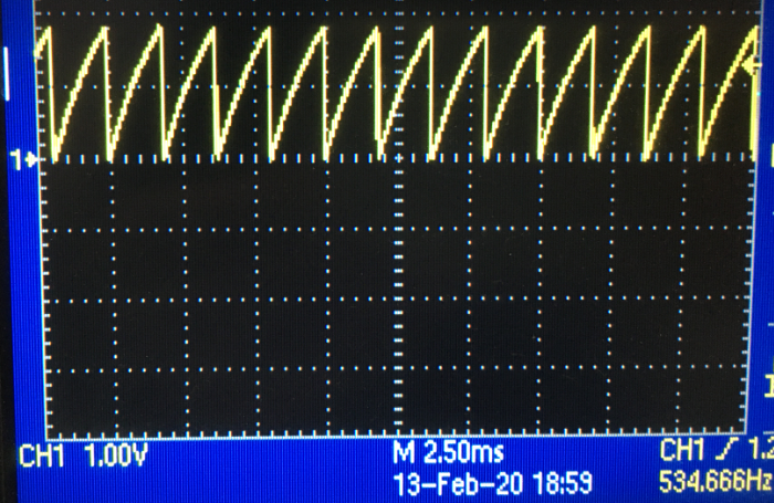

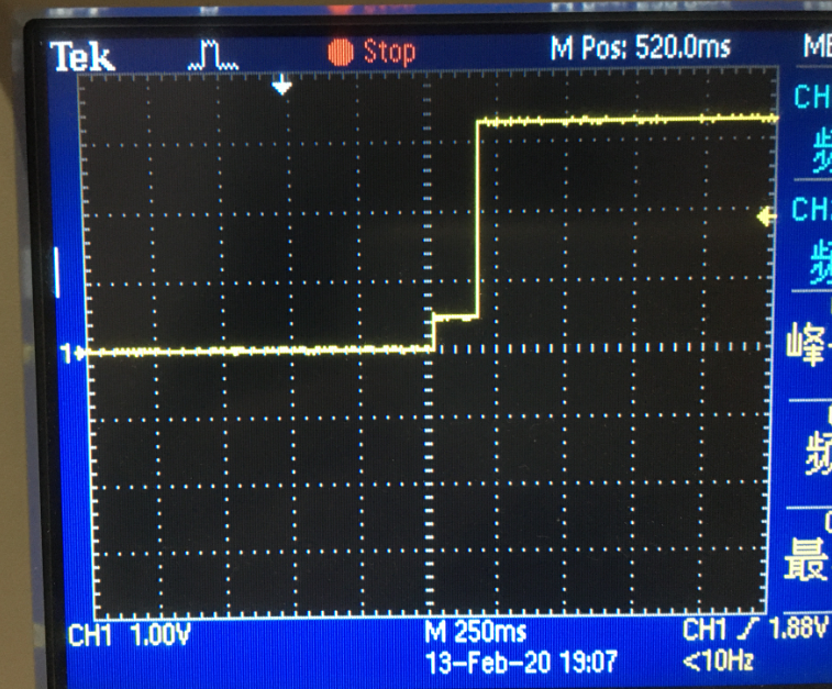

the external reset worked based on the oscilloscope but the MCU was not reset correctly when the RESET pin of MCU is connected to the external reset.

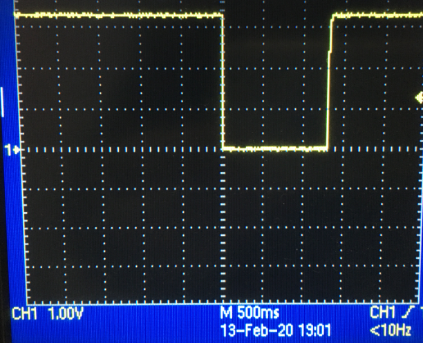

without a jumper, the signal at PIN 3 of J5 is like this followed by a manual reset.
with a jumper.  the signal at PIN 3 of J5 is like this

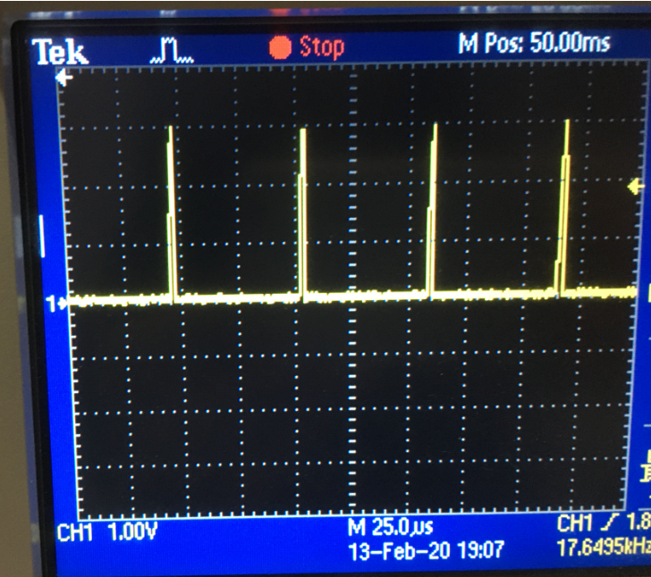

that's because the reset pin of MCU with no any jumper waveform is like this. That indicated MCU was not reset correctly.
The reset chip output waveform is like this if with no jumper, which indicated the reset chip works.
the waveform changed as the following one after putting jumper on.
All the above waveform proved the MCU was not reset successfully.

The saw-tooth signal appears when something fails in the reset circuit. I suggest you to check the wiring of the circuit.
This issue is not caused by mass erase operations.
