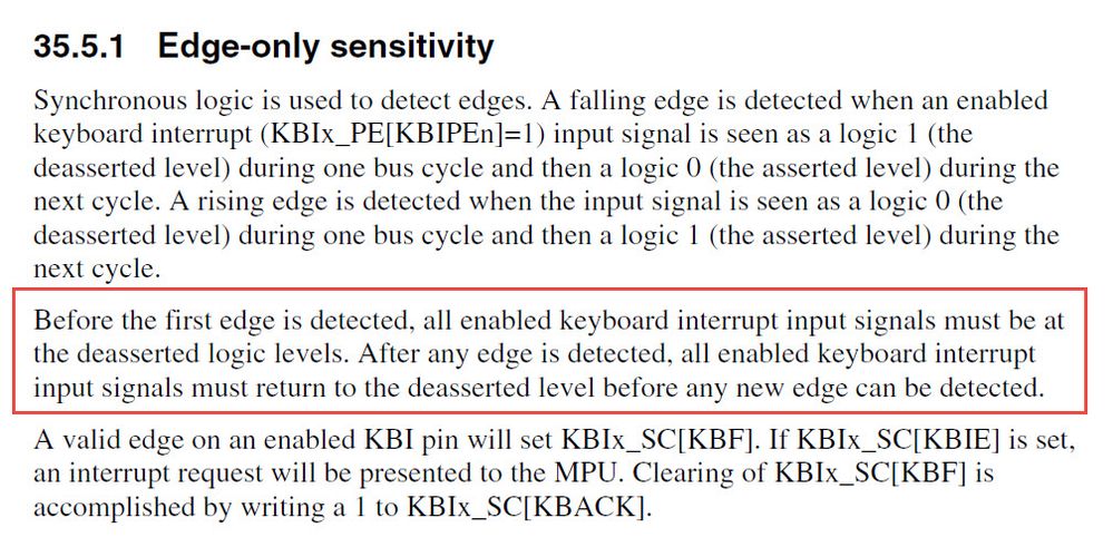

              I do not want to use GPIO polling since i am working with all the modules of KEA128 and also monitoring them. So how do i work with KBI for more number of switches (to be specific 12 switches), how do i work around the ISR or is there any other method ??

    Do you mean you need 12 IO interrupt?
    For KBI module, you need to take care of this point:
So, if in the same KBI module, only all the KBI pin is deasserted, then one KBI pin press can be enter interrupt, otherwise, the new KBI pin event will be ignored.
Please take care of the KBI limitation at first.
For the pin interrupt, there only NMI, IRQ and KBI interrupt!
Wish it helps you!
Jingjing

The KEA128 has a single IRQ line that can be multiplexed to a selection of pins.
The IRQ can be programmed to be edge or level sensitive.
If you need just a single IRQ line this is suitable. For more that one interrupt KBI is very similar since it can also be programmed for the same characteristics but has more inputs.
