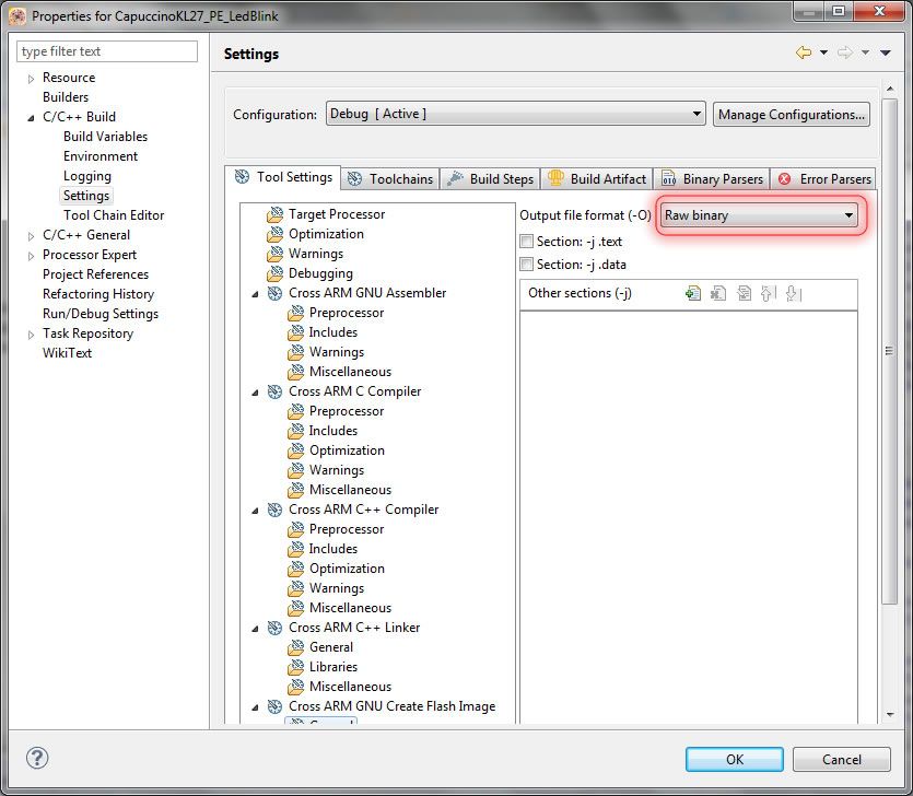

Perform some tests, but I do not understand how to set the configuration registers for the Bootloader can function after programming the Flash memory.
  1. KDS configured to generate .bin file to program microcontroller from Bootloader.test1.jpg
  2. I checked the binary file generated by a project for the KL27 Expert processor. The project has no modification, only that generated automatically. In position 0x0_040D meeting FTFA_FOPT settings generated by processor Expert with 0x3F value.
According to Table 6-2. Flash Option Register (FTFA_FOPT) definition ... 0x3F equals that will always start from the FLASH memory .. Especially the bits 6-7 (BOOTSRC_SEL = Boot from Flash) and bit 1 (BOOTPIN_OPT = Boot source configured by BOOTSRC_SEL).
For KL46Z is easy because ProcessorExpert amending LINKER and defines a memory space for these configurations and additionally generates a vector called / * Flash configuration field * / and has the values:

Any change in the vector immediately modifies the .bin generated and FOPT takes the values that I want. If I check the .map after compiling for KL46 I can find that:
*(.cfmconfig)
.cfmconfig     0x00000400       0x10 ./Generated_Code/Cpu.o
                0x00000400                _cfm
                0x00000410                . = ALIGN (0x4)
The specific question would be: How to get this same configuration but for the KL27.

Yong Li,
Thank you very much. With your instructions, able to successfully configure the bootloader option. I programmed the microcontroller and everything happens as expected. Reenters Bootloader but now I have another problem.
The settings in the memory locations are:
  • The values were verified in the generated .bin and were as expected.
  • I programmed the microcontroller using KinetisUpdater.exe... programming ended without any problems.
  • Try entering again into Bootloader mode and I could do it without any problems
  • Now I always get an error when trying to program a microcontroller again. Now I always get an error in KinetisUpdater.exe.
from blhost, you can see that answering the bootloader, but leaves no programming or erasing the flash
Apparently it is the memory register "Flash Security Register (FTFA_FSEC)" ... I had reviewed this register to set up the right way and I think I gave the correct values.
I gave the = 0xFE values corresponding to:
  • KEYEN = 11 Backdoor key disabled access
  • MEEN = 11 Mass erase is enabled
  • FSLACC = 11 Freescale factory Access Granted
  • SEC = 10 MCU security status is unsecure. (The standard shipping condition of the flash memory module is unsecure.)
something is wrong with what I'm understanding?

If Its value is equal to 0x3d, that means “Force Boot from ROM if NMI_b pin asserted (NMI_b pin is sampled at the end of reset (when reset pin negates)). otherwise, Boot from FLASH.
If Its value is equal to 0xff, that means "Always boot from ROM"
If Its value is equal to 0x3f, that means "Always boot from FLASH"
The above are three kind of typical configuration for boot source selection.
If you want to re-enter bootloader mode, you need to know the FOPT value on your KL27
