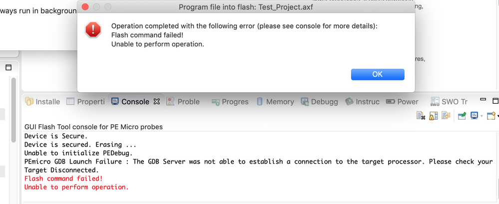

I developed board using MKL26Z128VFT4 MCU. After download first firmware (Hello Word) the device give error "Device is Secure. Erase to unsecure". If I click on "yes", pop-up comes again.
I tried use "Emergency Kinetis Device Recovery..." but without success.
I only have more one MCU so I can t do a mistake again (I can t find this MCU in Brazil and to buy from other country, it maybe take 1 month or more).
I m using Multilink Universal by PEMicro.
I tried on OSX and Windows 10.

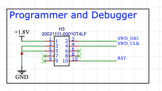

My schematic is similar to freedom.
The connections to MCU are direct, in other words, without any resistors or capacitors.

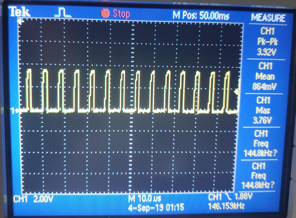

Unfortunately today I could not apply long time in this work. But I catch a oscilloscope to do measurement as Robin asked.
First... My layout no have nothing connected to NMI_b  different from what was requested in the item 3 of doc and I no do it yet because will be so hard, tomorrow I will try it.

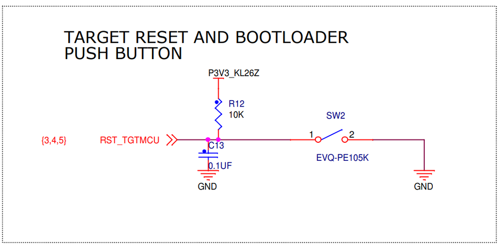

I have 10k pull up as asked in the item 2 (connected in the RESET_b).
Using oscilloscope I have continuous + 3V on NMI_b pin.
And figures below show signal on RESET_b pin.
1 - PCB with +3.6V and GND
Note that my sample time is equal to showed in item 6 of your doc, but signal of RESET_b have frequency higher than yours.

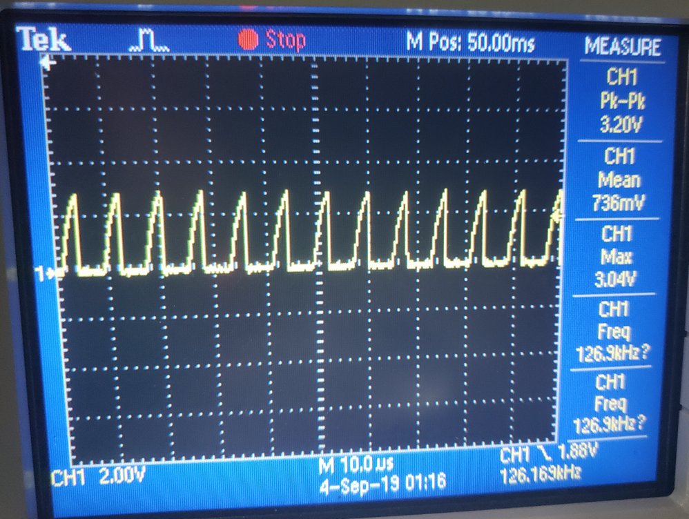

2 - When Multilink Connected
Following your Steps "resurrect locked Kinetis device in GUI Flash Tool", the error below appear:
I need do pull up on NMI_b pin, but without it, Do you want that I do any other measurement or check ?

The message basically indicates that the debug probe is not able to talk to the device.
It 'sees' a device, but that microcontroller does not respond. Check that your connection is really sound, and that you have not swapped pins or having any short circuit.
See as well Device is secure? | MCU on Eclipse .
I have collected a check list here: Debugging Failure: Check List and Hints | MCU on Eclipse
I see that your Vcc is 1.8V. The Multilink should be able to deal with this, but I had a case of a failed unit which only worked down below 2.5V. Maybe it helps if you can increase the voltage to 3.3V at least to check?

But when I check my layout I see that I no connect pull up in my reset pin like in freedom kl26z.
I do wire-ups and check that my "RST_Pin" no comes to 3.3 V (or next it), It stay next to 1.3 V and when I try flash firmware the Voltage below to 0 V.

BlackNight
Check the state of the reset line with a logic analzyer or scope: it seems to me that your device is constantly resetting? The reason for this could be that your code is constantly crashing.
