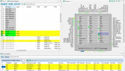

Hi guys,
I'm working with a RTC peripheral on K64 with external 32,768Khz clock and the time counter doesn't seem to work. In other words, the RTC->TSR content stay the same. I verified on the XTAL output and the oscillator is working correctly.
There is my init :
rtc_config_t RTC_config = {
.wakeupSelect = false,
.updateMode = false,
.supervisorAccess = false,
.compensationInterval = 0x0U,
.compensationTime = 0x0U
dateTime_st.u16Year = 2021;
dateTime_st.u8Month = 11;
dateTime_st.u8Day = 24;
dateTime_st.u8Hour = 8;
dateTime_st.u8Min = 54;
dateTime_st.u8Sec = 00;
/* RTC initialization */
RTC_Init(RTC, &RTC_config);
/* Select RTC clock source */
RTC_SetClockSource(RTC); // Same as : RTC->CR |= RTC_CR_OSCE_MASK;
/* Stop RTC timer */
RTC_StopTimer(RTC); // Same as : RTC->SR |= ~RTC_SR_TCE_MASK;
/* Date and time initialization */
RTC_SetDatetime(RTC, (rtc_datetime_t *) &dateTime_st);
/* Start RTC timer */
RTC_StartTimer(RTC); // Same as : RTC->SR |= RTC_SR_TCE_MASK;
My clock sources and diagram configuration :
Any idea ?
Thank you by advance.
Best regards.
Mota

Mota
Hi @nxf77486,
Thank you for your answer. RTC_CR_OSCE is well set to "1". I verified SR[TOF] and SR[TIF] bits and they are set to "0". Then the time counter should increment this value but it's not the case. The RTC_TSR counter stay always at the same value which is set at the beginning by RTC_SetDatetime().
There is the setup of my oscillator (It’s automaticaly genereted when I setup the clock sources) :
  /* RTC clock gate enable */
  CLOCK_EnableClock(kCLOCK_Rtc0);
  if ((RTC->CR & RTC_CR_OSCE_MASK) == 0u) { /* Only if the Rtc oscillator is not already enabled */
    /* Set the specified capacitor configuration for the RTC oscillator */
    RTC_SetOscCapLoad(RTC, capLoad);
    /* Enable the RTC 32KHz oscillator */
  /* Output to other peripherals */
  if (enableOutPeriph) {
    RTC->CR &= ~RTC_CR_CLKO_MASK;
  else {
    RTC->CR |= RTC_CR_CLKO_MASK;
  /* Set the XTAL32/RTC_CLKIN frequency based on board setting. */
  CLOCK_SetXtal32Freq(BOARD_XTAL32K_CLK_HZ);
  /* Set RTC_TSR if there is fault value in RTC */
  if (RTC->SR & RTC_SR_TIF_MASK) {
    RTC -> TSR = RTC -> TSR;
  /* RTC clock gate disable */
  CLOCK_DisableClock(kCLOCK_Rtc0);
And it’s call in my main() by :
BOARD_InitBootClocks();
You will find below my RTC hardware configuration, I use VBAT too :
I don’t have FRDM-K64 board to test these kind of examples and I’m working with a MK64FX512xxx12 instead of MK64FN1M0xxx12..
Thank you.
Mota
