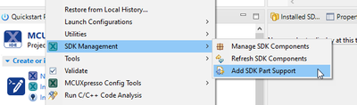

Hi @Javad_Baig ,
yes, you can do this. In order for the debugger to have all the needed files, make sure you have 'SDK Part support' added to the project:
Keep in mind: without the SDK installed, you cannot add files/drivers from it to the project: for this you need to have the SDK available.
