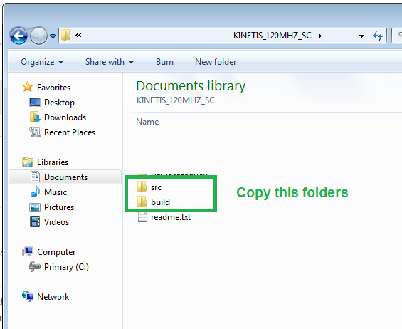

If you go to the path: C:\Users\b50274\Documents\MCUs\Samples\KINETIS_120MHZ_SC\build\cw you can find there a cw_readme.txt which contains the instructions to build correctly the sample projects. Basically you can do the next steps:
  • Close CodeWarrior.
  • Inside the KINETIS_120MHZ_SC you can see there are two folders: src and build. You can copy or cut this folder, we are going to move them. In the cw_readme.txt document says to set the workspace to the folder but I find this way simpler.
  • Open in windows explorer your workspace location, typically the location is C:\workspace.
  • Paste inside the workspace location the src and build folders. This is because the paths of the sample projects are relative to the workspace location and if you do not have those folders there the compiler will not be able to find the files.
