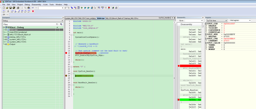

2. Your SysTick_Config(48000000); is wrong.
  As you know, the systick is just 24 bit counter.
__STATIC_INLINE uint32_t SysTick_Config(uint32_t ticks)
  if ((ticks - 1UL) > SysTick_LOAD_RELOAD_Msk)
    return (1UL);                                                   /* Reload value impossible */
  SysTick->LOAD  = (uint32_t)(ticks - 1UL);                         /* set reload register */
  NVIC_SetPriority (SysTick_IRQn, (1UL << __NVIC_PRIO_BITS) - 1UL); /* set Priority for Systick Interrupt */
  SysTick->VAL   = 0UL;                                             /* Load the SysTick Counter Value */
  SysTick->CTRL  = SysTick_CTRL_CLKSOURCE_Msk |
                   SysTick_CTRL_TICKINT_Msk   |
                   SysTick_CTRL_ENABLE_Msk;                         /* Enable SysTick IRQ and SysTick Timer */
  return (0UL);                                                     /* Function successful */
From the sysTick_config function, you can get that if your make ticks=48000000, it is larger than 0xffffff, then it will return 1, it won't configure the systick any more.
If I define it like this:
sysTick_Config(48000), the code will enter SysTick_Handler.

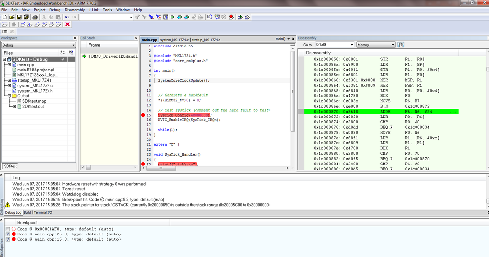

Further update. We created a tiny example project that exhibits the problem. Below is a screenshot of what happens after we trigger a hard fault (line 12). We never break in the hardfault ISR in startup_MKL17Z4.s (part of the SDK). When we halt the processor we are somewhere in the boot ROM.

Almost certainly you haven't set the vector base register to match your interrupt vectors or you haven't installed interrupt handlers. In such a case a hard fault will result in a second hard fault (unrecoverable) and thus provoke a reset - which ends up in the boot loader again.
