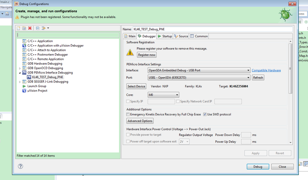

I have been trying to use Kinetis to debug KL46Z256 and I receive an error:
What I have done so far:
1. Install on different operating system
2. Update the bootloader
3. Update the kinetis
4. check the KL46Z256 drivers.
5. Change the cable and USB port
6. Change the kl256 with a different kl256
7. I get a similar error with Code Warrior as well.
I can program KL256Z with the mbed online compiler and no problem.
Can anyone help?
Bee Zee

   Do you mean you are using FRDM-KL46 board, just use the on board debugger, and program the debug as the opensda, but this on board opensda can't program the on board KL46 chip? Or you can't program the external KL46 chip?
  Please help me to confirm the question.

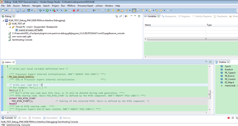

I have test my FRDM-KL46 board, use opensda firmware, it works OK.
Please check your FRDM-KL46 board, you must make sure j17 is short, or R2, R1 is connected.
This is my test result:
You can try my attached project, then test it on your FRDM-KL46 board, if you still have problem, please let me know.

Thanks, your advice helped me to find the problem. J18 was disconnected on FRDM-KL46Z so I connected it.
Bee Zee
