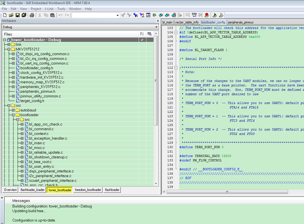

1. open KV31 bootloader project in folder:NXP_Kinetis_Bootloader_2_0_0\targets\MKV31F51212
2. Choose tower_bootloader project, build and download it with your debugger.

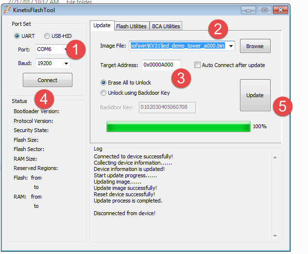

5. Configure it like this

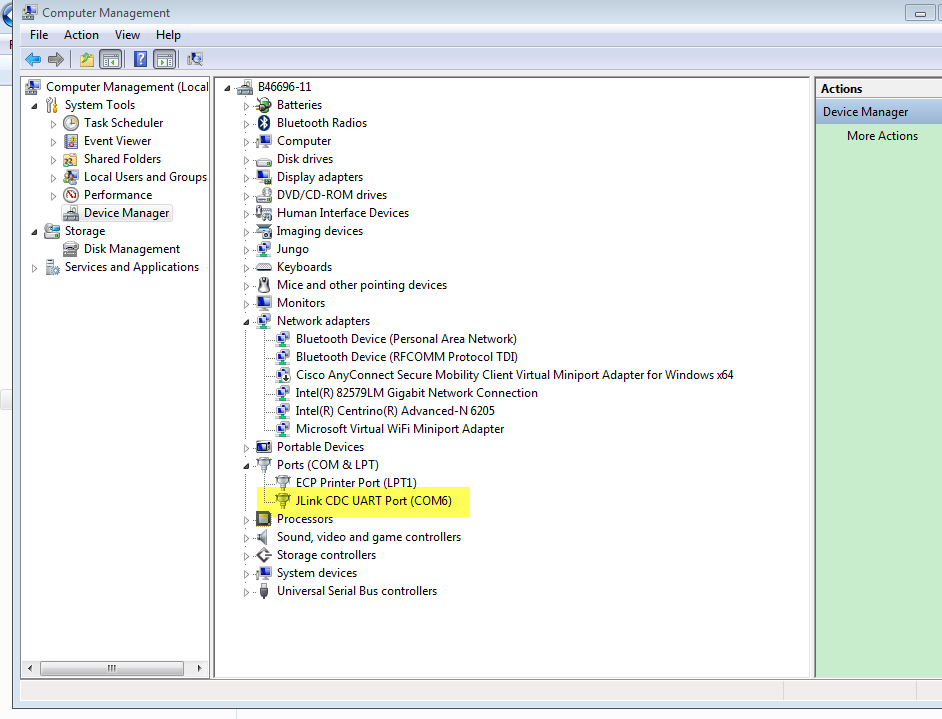

COM port should connect your board virtual com port, you can check it in your PC device manager:
Before you click connect button, press the on board reset button at first.
From my above picture, you can find I can download the application file, and after I download it, I can see the on board LED blinking.
