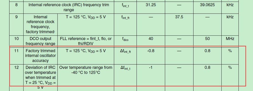

    I want to know about the below things:-
1) I want to know the precision of Internal RC oscillator of KEA-128?
2)Per year what will be the time lag generated due to decaying of the Internal RC oscillator?
Please provide us supporting Documents with Screenshots :smileyhappy:
  You can find this data in the datasheet
Factory trimmed internal oscillator accuracy : -0.8% ~0.8%
Deviation of IRC over temperature when trimmed at T = 25 °C, VDD = 5 V: -1% ~0.8%
  We don't have this data now, but if you very care about the clock accuracy, I suggest you use the external crystal which have higher accuracy.

Hi Jing,
           Ya I can understand that.The Screenshot you have shown is showing T = 125 degree C whereas your answer shows 25 degree C.Can you please clarify on that?

     Deviation of IRC over temperature when trimmed at T = 25 °C, VDD = 5 V: -1% ~0.8%, it is trimmed at 25 °C, and when the temperature is changing, the accuracy may have deviation.

1) Do we have IRC Deviation Data over Different Temperatures ???.
2)I want to know how to change Trim value ICS_C3 based o Temperature changes?
1,479 次查看
kerryzhou
Hi VIGNESH,
1) just have the range as the datasheet has described
2) If you want to do trim, just in 25°C is OK, but take care, the internal IRC is really not very accurate, if you want stable clock in your system, I suggest you choose the external crystal, it will make your system more stable.
