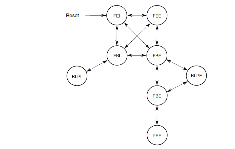

Dear Sirs or Madams,
Could you please let me know when Lockup event occurs?
I now understand that the LockUp event can occur when the frequency of system clock of K61 is set too fast,
thanks to supports of NXP engineers.
But, I want to know whether there are any other factors which can cause LockUp event,
in addition to excessively high frequency of the system clock.
Best regareds,
Shinsuke Tanaka

Sorry for the late response. Answer to your questions, see below:
1. The Clock transition not just mean MCG_C1 changing. See below diagram. These are the MCG restricted transitions modes.
2.  Yes, your understand is correct.
3. Here means all system memory and memory interface.
4. Yes, this maybe also cause the lockup.

There really has a few of factors that led to system lockup, from core to bus. Just for examples that may cause core lockup:
1. An incorrect Clock mode transition occurs
2. The clock part is over-clocked
3. Code executes after POR, if a part memory is not programmed
4. Broken external oscillator
4,088 Views
tanaka_shinsuke
Dear Mr.Li,
I appreciate your information.
Could you please respond to my additional questions to your feedbacks shown below?
   -> I now guess that "Clock mode transition" means the changes of values stored on the registers
      prepared for clock settings, such as MCG_C1 register.
      Is my guess correct?
      If my guess is correct, please let me know what "incorrect" means in detail.
  ->Does this mean that the frequencies of clocks used inside K61 are set to excessively high?
  ->Does the "memory" mean the DDR connected to K61 externally?
  ->Will LockUp also occur when Circuit Matching between K61 and external crystal oscillator is NOT adjusted appropriately
      on the PCB?
I'm sorry to bother you repeatedly, but I need your help to deepen my understandings.
Best regards,
Shinsuke Tanaka

miduo
