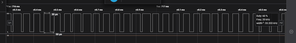

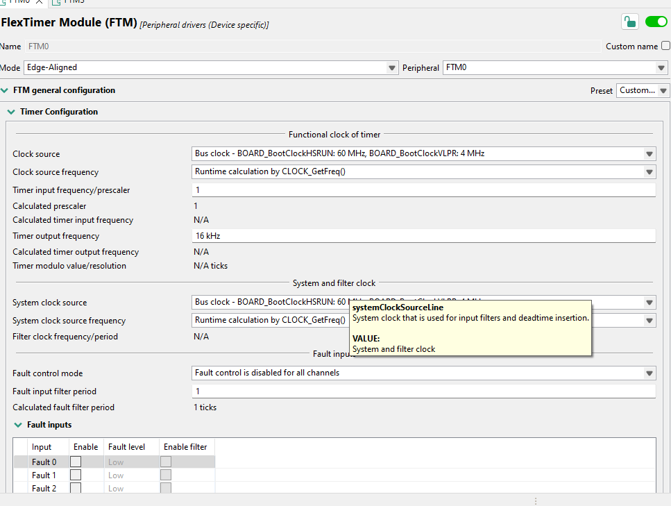

In kv31f512vll12 configured FTM0 PWM generate to set 16 KHZ frequency and Duty cycle 60% but PWM output pulse
not constant its like varying 65%,70%.if any changes of timer configuration guide me and
how to constant PWM generation also if any one know let me know.
how to configure constant khz and duty

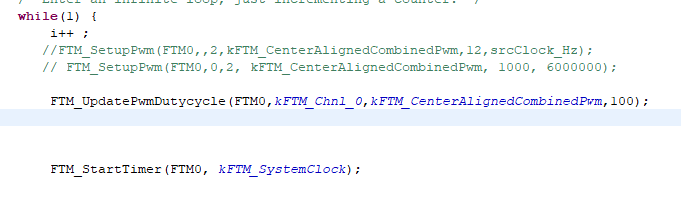

I want to duty change means duty also not changing.

I suggest you call the FTM_UpdatePWMDutyCycle() in the FTM overflow ISR rather than calling it in main loop while(1) in main.
If you call it in main loop, you call it too frequently.
Hope it can help you
