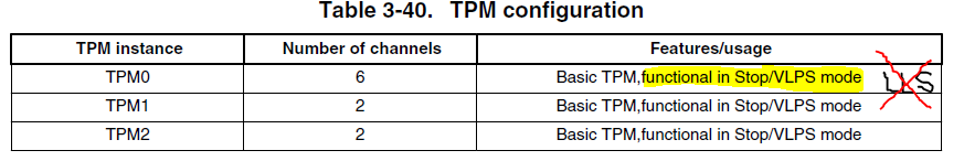

In the meantime I have however noticed the following in the KL25/26 user's manuals which is probably actually declaring that the TPM can't be used in LLS. Interpreting this as listing the 'possible' low power modes where the module is operational (and in all others it isn't) I now believe that the restriction is that VLPS is OK but LLS not, even if the clock used by the TPM continues to operate in the LLS mode. Of course in VLPS the clock used must also still be enabled for it to work.
Therefore I think that the VLPS mode is indeed the lowest power mode possible with operational PWM output.

The binary that I had attached is for the FRDM-KL26Z (although will presumably also run on a FRDM-KL25Z but uses different outputs).
To move to a low leakage mode you need to command this on the serial interface in the "administration" menu - you can then switch to which ever one you would like try.
When switching to VLPS the PWM output continues to operate. The application will however move automatically between RUN and VLPS mode whenever it needs to, and can.

Yes, I can confirm that it's not working whatever way I try it.
Although the manuals I looked at (Data Sheet, Reference Manual, User Guide), seem not as specific regarding TPM as the one you have. Thank you for sharing this information.
