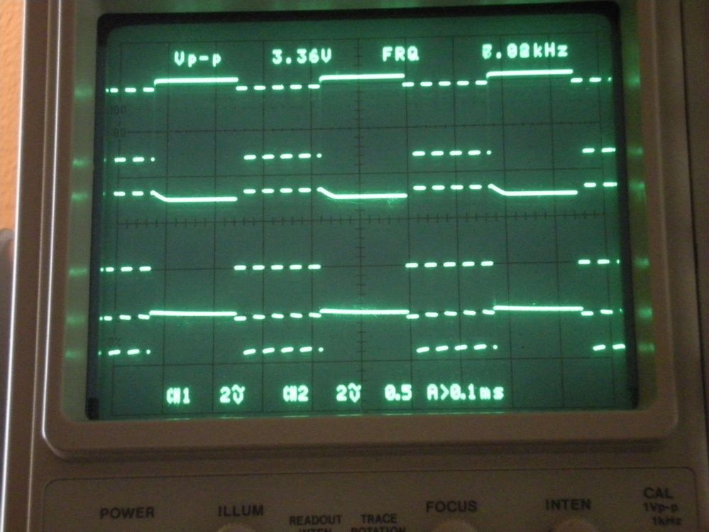

Hello, I'm using a FRDM-K64F and some custom hardware to spin a 3-phase synchronous ac motor. The motor will spin at it's native speed, 1200rpm, but it has to remain phase locked to the zero crossings of the ac line. The motor is a rotating spark gap for a tesla coil and the 6 firing electrodes must be in the same place on the ac cycle every time.
As you can see from the enclosed KDS 3.0 and PeX project I have used 6 pwm components and a ppg. I use the ppg to make the fine frequency adjustments that are needed to sync the pwm outputs to the zero crossing pulses from an external op amp circuit. That works great. Pairing of the 6 pwm outputs and dead time insertion is all done in my C code but there's a problem. When I disable one pwm output in a pair it doesn't go off. That is essential to avoid putting the igbt's on my power inverter board into a dead short. It's hard to see these signals accurately even though I have a good scope so I added a little test in my code. It puts out 4 fixed width pulses on one pwm output, then disables it and sets it high, then puts out 4 pulses on another. I should see the exclusive swapping of channels on my scope but I don't. I see them both at the same time with lots of overlap.
So what am I doing wrong? Should I use the pwm interrupts instead of the ppg? So far I need the ppg to make the fine frequency adjustments I need for syncing. Is there some other low level method of disabling a pwm channel? Any help will be greatly appreciated!

Hi, Dave,
As I said that the PWM1_Disable(); function clears the the CLKS bits in FTM_SC register, which leads to  stop of the FTM, so all PWM channels will be disabled after you call the PWMx_Disable().
If you just want to disable some PWM channels, while keep the other PWM channels running, I suggest you use mask function. Setting the CHxOM in FTM_OUTMASK register makes the FTM_CHx channels masked, in other words, the FTM_CHx pin becomes low or High which is specified in FTM_POL register.
If you want to mask the PWM channels, pls refer to the section 40.4.11.7 OUTMASK register synchronization. Clearing the SYSCHOM bit, after you write the FTM_OUTMASK register, the corresponding FTM channels with CHxOM set bit will be come high or low, the corresponding channels with CHxOm bit cleared will run normally.

Okay so I figured it out. I made a simple test project in KDS 3.0 using PeX. It has 3 PWM components all running off Timer3 on channels 0, 1 and 2. There is also an Init_PIT component that generates an interrupt. On opposite cycles (determined by a boolean) of the interrupt, I enable and disable only ONE of the 3 PWM outputs. Like this:
void onek (void) {
  PIT_PDD_ClearInterruptFlag(PIT_DEVICE, 0);
    swap = !swap;
    if (swap) { PWM1_Enable(); }
    else { PWM1_Disable(); PWM1_ClrValue(); }
When I look at the output of the 3 PWM's on my 3-trace oscilloscope, I see that ALL 3 of the outputs are enabled and disabled. Even though I only wrote commands for one channel. I can choose any channel to modulate in this way and the other 2 will do the same thing. So the PWM(n)_Disable statement is disabling all PWM outputs that come from the same timer.
This can't possibly be expected behavior.
Please let me know how I can switch off only one channel at a time.
