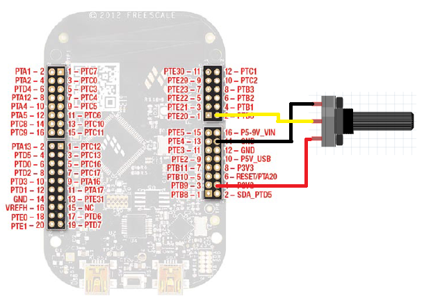

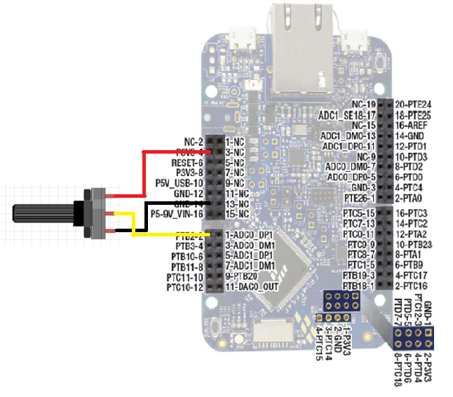

The following example uses a PIT to start an adc conversion, once the conversion has finished it issues a DMA request and the DMA controller stores the converted value in a buffer. The examples were implemented in both CodeWarrior 10.6 and KDS 1.1 for every board.
The recommended test circuit is the following:
Please feel free to modify the files, I hope this examples will be useful for you and will help you by decreasing your development time.
