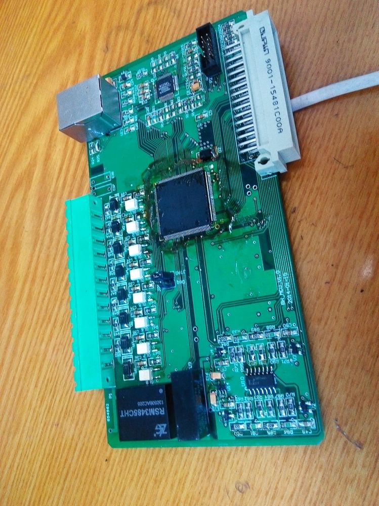

Hi all,
     I am using MK60FX512VLQ12 in bare-metal mode. Every 0.833ms it will perform ADC . The loop in the main() do some Key Scanning and
Uart Sending. No other features in its code. Now the K60 chip will be overheated(may be 60℃) after 20 minutes' running. If debug K60 with
J-link, it will be overheated(may be 90℃) in less time.
     The chip runs well and can be debugged.
     What could be the problem and how can I identify it?

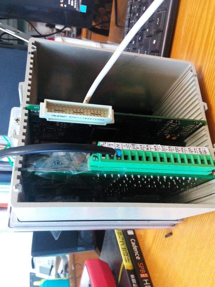

That's how the cpu board should be used, in a box with other boards. Initially, I guess the over heated problem
was caused by the  power board. There is a big AC/DC module on power board.
So I pluged the CPU board out and soldered a 5V power on LM1117 pin directly as showed after.

I measured current of the whole CPU  board and it is 0.341A.
There are four modules on the CPU board:  Internet port, RS485 port, EEPROM, IO port. But none of these modules were
used in the project code. The CPU only do A/D conversation every 0.833ms with the internal ADC.

       I soldered another board and no overheat problem occurred. So that MCU on the overheat  board
may has something wrong.
     I checked the MCU and no pins was shorted. And the MCU still can be linked with Jlink.
     So, it is strange. The temperature in the box which contains the MCU board is a little bit hot, So I guess
may that cause the MCU to be destroyed but not totally destroyed.

Hi Vicente,
Actually, the board was good in the beginning. And days later it went to wrong so I soldered another MCU on the board. It keeped well
for another days and then went wrong again.
So I suppose the box's high temperature  is the cause.
I chang another new board with new MCU and check what will happen.

     I thought I find the problem. The box we use is made of metal and it let two boards be shorted.
Thanks.
